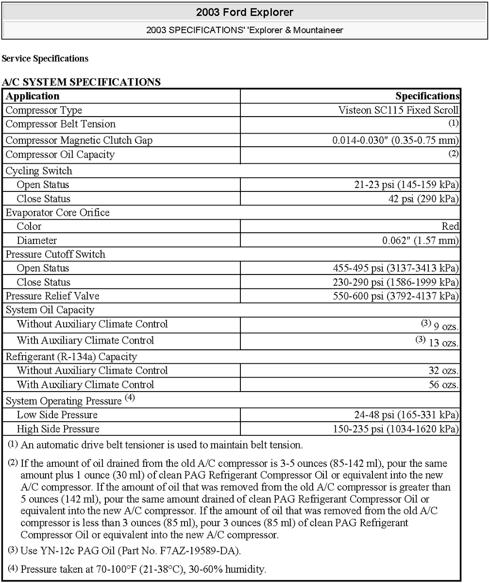

The easiest way to go about it without a scale and all the specialized equipment is to vacuum down the system then add exactly 3 cans. Capacity without rear a/c is 32oz's. 3 cans is 36oz's. So when you consider hose loss and the cans not emptying all the way that roughly accounts for the 4 extra oz's.
Does this guy have his EPA certs to buy R12/R22? I do.
Here are the A/C specs for anyone that needs them:
Oil type is PAG 46.
