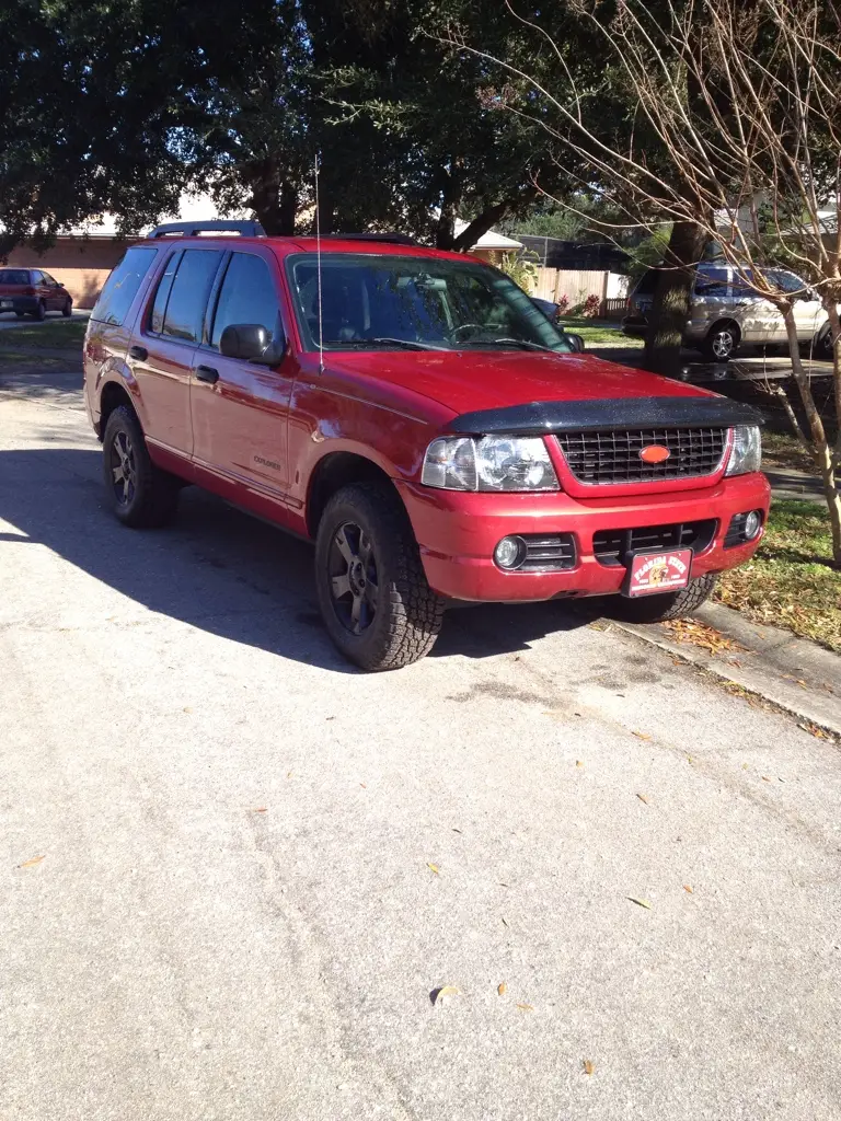

ive gotta 02 eddie bauer with the stock alloy rims on it, and im plannin to paint em black what would yall recommend to use and if yall have done it can yall write me up a step by step

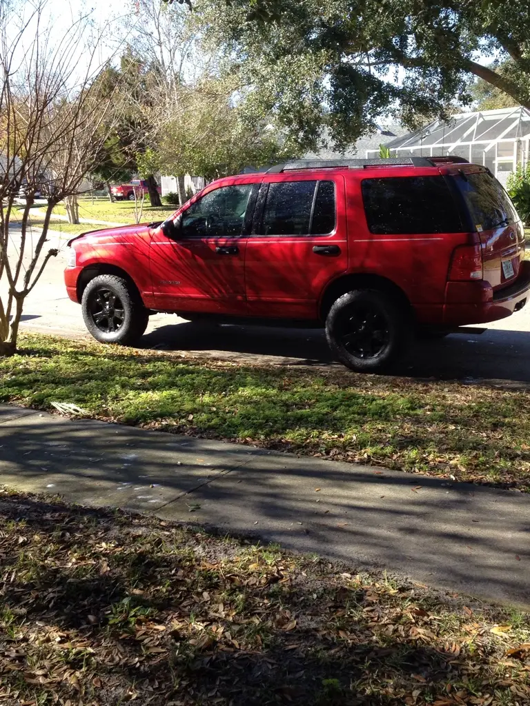

Tape is a pain the ass! Use the deck of cards for sure I just painted mine..sand them down alittle bit clean the hell out of them, prime them let it cure and the throw some layers of paint on there. And to be honest don't use clear coat.

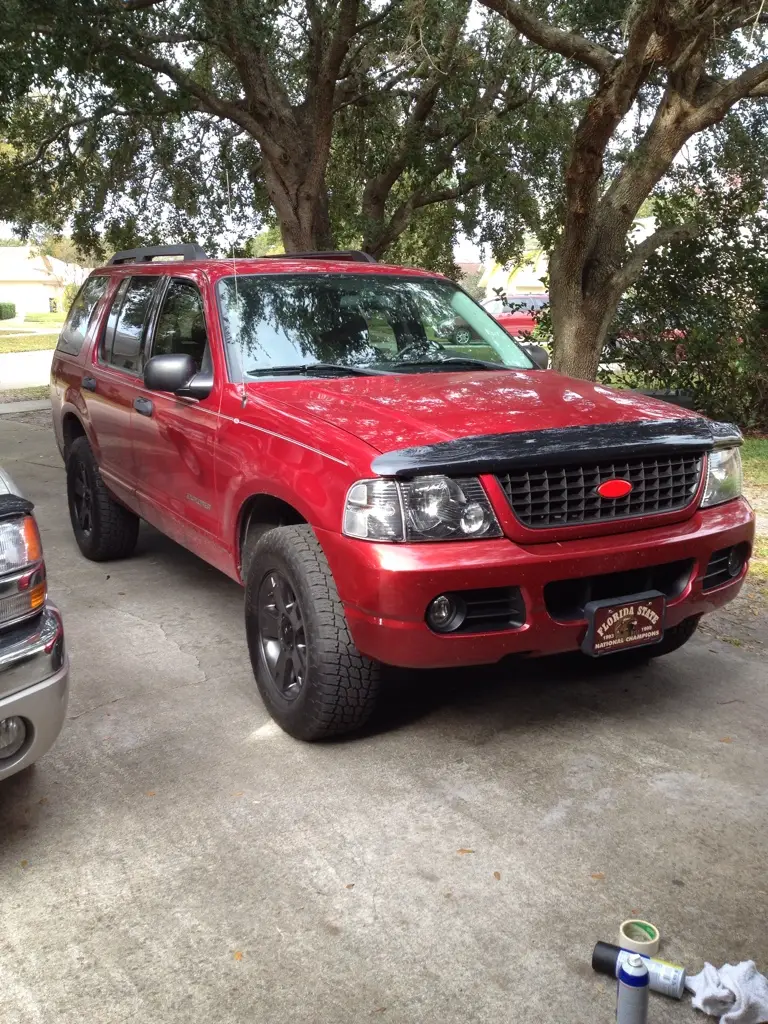

I ended up doing two coats of satin black , two coats of gloss black, two coats of uv resistant clear coat. Then i didn't like how it looked so I finished with one more coat of gloss black...
its been 2 years and theve been through 2 winters and they still clean up real nice and dont show any signs of chips or fading.
