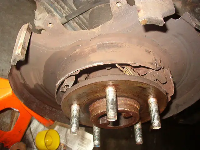

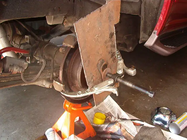

alright guyz here is my situation, today i went to pull out of my driveway and all i hear is an horrible scraping an crunching sound. Well guess what, its my emergency break pad in side my rotor being ground up. So i'm like ok we will just take the rotor off well we soon find out that we can't because of the break pad being wedged in and preventing us to take it off. I am at loss for ideas, we have tried everything and there is no tention on the ebrake. Also, i need this fixed by sunday night, i need to drive it up to college and i can't afford not having a vehical.....plz...any help or ideas are very well needed...THANK YOU!!! i've attached a photo because i think its funny how we had been pulling on it.

well right there you are pulling on the caliper bracket instead of the rotor. Get a rubber mallet and pount from the inside. Rotate the axel around to keep banging around the rotor. Dont forget to cote aroudn the hub and lug nut areas with pb blaster
booming- no its on the rotor, just in the picture it doesn't look like it. If i can't get it off with a pulley puller then it aint coming off with an hammer. I've tried the hammer, i've soaked it in pb blaster an nothing. it is not rusted to the spindle at all, i can move the rotor around, its hanging up on the ebreak.
The parking break isn't even hooked up to the foot application lever, so there is absolutely no tension on the lines at all.
My problem here is the ebrake pad is preventing me from pulling the rotor off.
Thanks for the tips guyz... :thumbsup:

The p-brake adjuster can still be unscrewed, and may help you out a little.
That puller looks WAY too small for the application. It looks like it may be pulling the arms "in" instead of pulling them "out."
I don't have any great advice on the situation. Keep on soaking it, :hammer: 'ing it, and using the puller.

ya that puller is way too small

alright thanks guyz, i'll keep beating on it all today and let you know what i find. The only problem with a bigger pulley puller is that the arms are way to be to get in between the protecting shield, so I'm stuck with what i got. If you guyz know how to get the shield off then let me know, but to my knowledge its riveted to the spindle plate....wish me luck...thanks

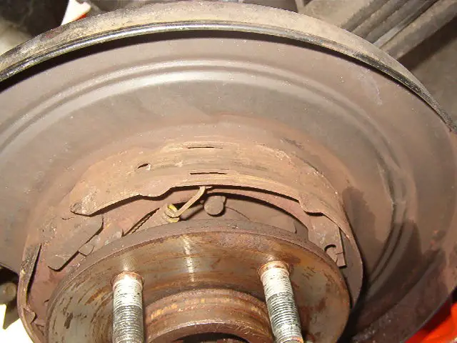

thanks guyz for all the help, i was able to get the rotor off. what i ended up doing was putting the pulley puller on the rotor horizontally and then beating the end of the pulley puller to crap, from left to right to hopefully wiggle it out and it worked. did it for like 5 mins and bam off came rotor... :D Well this is what i found...(see attached photo)
let me tell you what, I HATE DRUM breaks...lol...i finally got the old ones off and got the new ones on. well i'm remounting the tire and i look across at the other side and the cable came off the lever... :rolleyes: ...so i had to go over and put it back on and now it won't stay on, so i'm done, i've giving up on it, i will replace the other side next weekend. I've had to much this weekend...lol...thanks again for all the help and the motto "Get a Bigger Hammer", it works.... :thumbsup:
