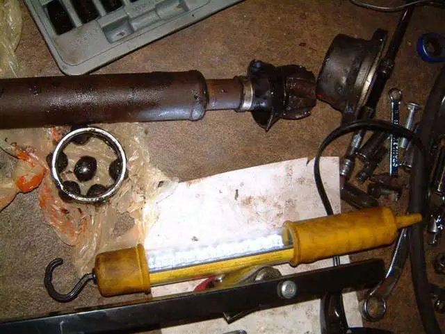

Turns out that the driveshaft was never supposed to be seperated at the end where the CV joint is. Didn't know any different since the manual didn't say and this is my first time doing something like this. So when I went to tap it out of the transfer case and the one part stayed fixed to the case, I didn't think twice.
See the pics here:
