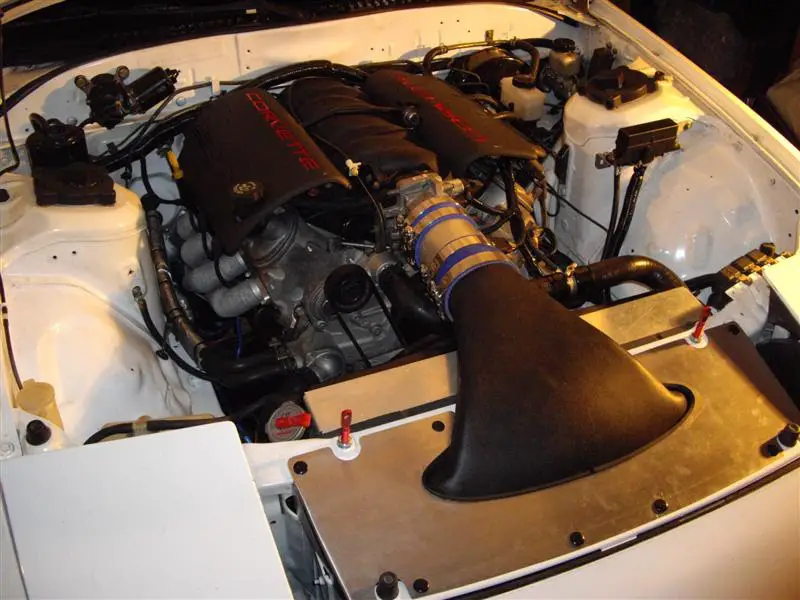

It's a great conversion, here's a fews shots...

Motor added about 60 lbs and I'm still 50/50 weight ratio. ;) I like to tell folks that I tripled my horsepower, quadrupled my displacement, but my gas mileage still went up vs. the motor that came out. Yes, it's a street car. I even have A/C.
