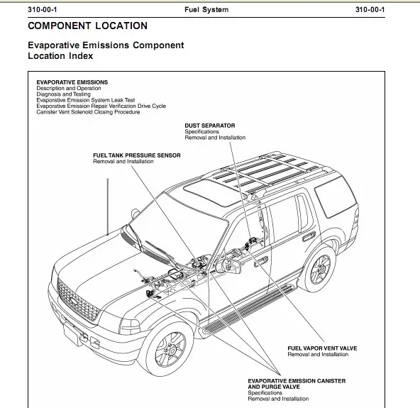

As mentioned earlier, I haven't been able to locate the canister. The linked thread say to the side of the spare but I am unable to locate it (my first Ford). Could you offer a location description or pic?

Here is the illustration from the 2003 WSM for where these emissions parts are located. As you can see there are 2 evap canisters and they are both located on top of the gas tank requiring dropping the tank for access. The vent valve and tank pressure sensor are also on top of the tank. You can get at the purge valve for inspection w/o dropping the tank though.
