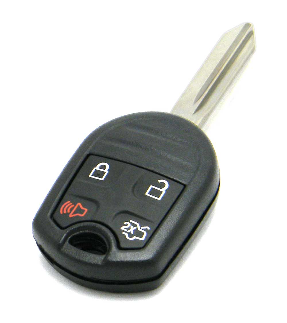

If you're not going to describe your situation well or answer questions, no one here will be able to assist you. What does your actual key that goes in the ignition look like and how many buttons does it have?That's only for the remote start. I have to press the lock button the key fob first. Then I press the start button on the second fob
Doing the best I can here. This is the key fob that came with the car.If you're not going to describe your situation well or answer questions, no one here will be able to assist you. What does your actual key that goes in the ignition look like and how many buttons does it have?
Do you have 2 of them?Doing the best I can here. This is the key fob that came with the car.
2 of the 4-button key fobs I meanDo you have 2 of them?
Yes, and both key fobs work properly. I have also tried both remote start fobs and get no response from either one. The red led on both start fobs blink when I press the start button. I have also checked both start fobs at Auto zone. Both are transmitting.Do you have 2 of them?

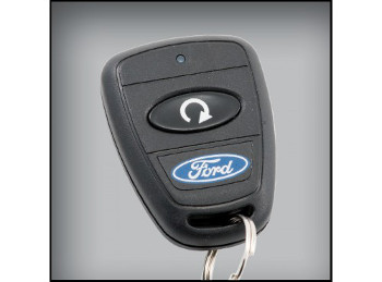

Yeah, I can't really understand what was done, so solutions are evasive. It seems the ford dealer either sold him a key fob with 1 button to compensate instead of programming a proper 5 button fob, or they installed an aftermarket unit and this is the magic button for the aftermarket unit. Given that he says the sequence for remote start is lock-lock-start, I think he has an aftermarket unit, which sucks. Otherwise I would have advised to get a 5 button fob and reprogram, or just turn off and then on again with FOR SCAN. Doubtful this can be fixed, you've been had.I'm a little confused. Doesn't this generation, ALL (? or just XLT trim and above) have the capability to remote start with the factory hardware, then the only difference being how the computer is programmed (enable value for remote start toggled on), then having the 5 button remote supplied instead of 4 button? I could've sworn I once read a topic on how to do this, using Forscan on windows with the extended (or whatever it's called) Forscan license to enable it.

Thank you Jason. That may have been a nice thing to have mentioned upfront. I guess the picture of the remote may have given it away but as someone that hasn't seen one before it was a little confusing.People...the OP has the Ford long range one way remote start system installed. This involves having the VSS installed and an antenna and the one way remote. The OP only has to use one button remote to start the vehicle.
OP could barely describe their situation. Thank you for the clarification jmr061.That may have been a nice thing to mention upfront. I guess the picture of the remote may have given it away but as someone that hasn't seen one before it was a little confusing.

Thanks that's kind of what I was looking for. I bought this car used otherwise I wouldn't even have a remote start ( I can't stand them). Also I wasn't aware that the antenna on the windshield was supposed to have a wire attached to it.People...the OP has the Ford long range one way remote start system installed. This involves having the VSS installed and an antenna and the one way remote. The OP only has to use one button remote to start the vehicle.
@OP, a few things. You don't need to have the system removed for any reason. If it isn't working you may want to find the VSS module which is likely mounted somewhere under the driver side dash above the brake pedal area. Take a look and make sure no plugs have pulled out. There should be an antenna mounted on the windshield. Following the wire back down into the dash will lead you to the VSS. I may have missed it but have you checked the battery in the one button fob?
Because this is installed, the remote start is enabled on the vehicle. If you just want to by an oem IKT (thats the key with the fob built in) that has the remote start button on it, as long as you have two functioning IKTs you can program the new one to the vehicle after you get it cut and use that to remote start the vehicle.
Not sure if this relevant at all, but we just cancelled service for a Viper remote start we had installed on our 2001 Ranger. Our remote looked very similar to yours. The remote worked on a 2G service, but as of 2016 AT&T stopped supporting their 2G network, T-Mobile shuttered theirs in Dec 2020. It's expected that by 2021 the rest of the national network will be shuttered altogether. Our remote had stopped working in Dec 2020.The Ford Dealership says they can't repair the remote start on my wife's 2015 XLT. Anybody have an idea how I can just remove the thing. I want to install one from 12v systems but I don't think I can until I remove the current system.
