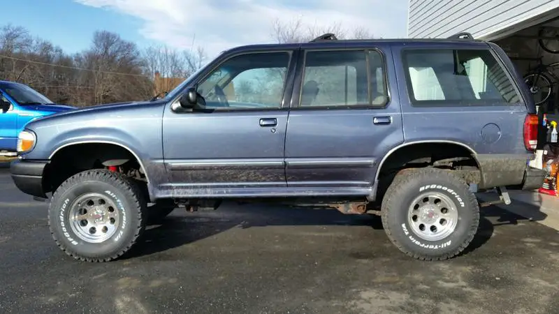

Thanks for your reply man! Do you think you could post some pics of how yours looks with the 33s? How high did you go with the torsion? I have a 2wd so I know I can go higher than 2 inches. Plus yea I already bought my wheels they're 15x8 with 3.75in backspacing.
ex1_zpse23b992d.jpg~c200
Here she is

Yea, pretty much the same setup as mine, minus the body lift. I have 0 rub issues but as mentioned I did trim the bumper and a little sheet metal on the fenders. The short flares hide the trim though
