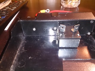

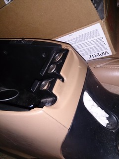

Im not sure if I am posting this in the right section but i wanted to share something i installed before i sell my truck. I installed a hidden push button start into my coin holder in my 96 eddie bauer if anyone has any questions about how to do this yourself i can tell you what you need and make up a walkthrough about how to do it yourself. here are some pics
right now i have it set up so that you turn the key to the run position and then flip one of the switches to turn on the push button start then you push down the nickel coin slot witch still functions and can hold a couple coins.
here is the pick of the back of the push button to give you an idea of where it is and how i put it in
here is where i put my switches on the metal bar that is behind the kleenex holder which i actually had to cut part of it out so that i could put them there

the reason why i did this was more for security purposes because cars get stolen here in the twin cities all the time and I also did this when i got bored one day, you push down the nickel slot of the coin holder after you flip a switch on that cuts the power to the push button switch to turn the vehicle on. and for this to work you either have to turn the key to the on position and have 12 volts be wired to the toggle switch then from the toggle switch to the push button and then to the red wire with a light blue stripe that goes to your starter relay. the other way you can also make this work is if you wire in more switches two turn on the other accessory power and run which i can also explain how to do in detail if anyone would like to know. i will be posting up a how to on the install i shown above shortly
