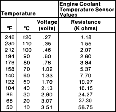

Another possibility is the coolant temperature sensor (the one that connects to the PCM) may not be functional. If there is an open connection the PCM may think the engine is cold and increase the richness.
You can disconnect the PCM connector and measure the resistance between pin 38 (LT GRN/RD) and pin 91 (GY/RD).

The pins I posted are for the engine coolant temperature sensor for the PCM. The EGR valve gasket is between the EGR valve and the mount.
Both sensors are brand new, and I don't have a way to test the resistance on them, I'll try abs get in to look at the writing and make sure it all still looks ok and isn't damaged

resistance readings?
Just got the meter from harbor freight and tested then and both work good, . .
What was the ECT sensor resistance at the PCM connector?
Where did you measure the resistance of the engine temperature sender? What was the resistance? Does the engine temperature gauge work now?

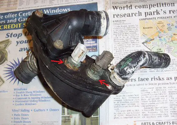

I don't remember the resistance off hand I'll check it tonight after work, but no the gauge still didn't work, and also just a thought but there was two didn't types of the bigger gauges I could of gotten, should I have gotten the cone shaped tip one or the one with a small cylinder shape on the tip and then the other sensor I replaced was the smaller diameter one
gauges vs sensors?
. . . and also just a thought but there was two didn't types of the bigger gauges I could of gotten, should I have gotten the cone shaped tip one or the one with a small cylinder shape on the tip and then the other sensor I replaced was the smaller diameter one
Your statement is puzzling. Sensors are the electrical devices in the thermostat housing.

Sorry that was a little confusing I'll try and rephrase the question better, there are the two sensors in the thermostat housing, first which sensor controls the gauge and which controls the computer?, second, of the two sensors one is larger than the other, when I went to buy the new larger sensor there was two options one had a cone shaped tip and one had a small cylinder shape on the tip, which is the correct tip?
