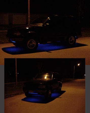

Installed StreetGlow Gold Series (blue) In
Ok friends.....Heres my new neon pics.
I just finished installing them my hands are still dirty.
I ran right inside and wanted to post the pics :)
They aren't that great and I hope they aren't too dark.

Ok as much as I hate to admit when I'm wrong. I definatley notice a difference between the streetglow 9" chrome and the 9" regular neons. I know this because I broke a chrome neon (within hours of receiving it) and got a regular set...I used 1 chrome and 1 regular and I'll be damned the regular one was brighter. So now I'm using the regular set under the driver and pass. dash. Don't get me wrong the chrome minis are sweet, especially if you have them where they will be showing. But there is a noticeable difference in brightness. BMXboy I will never doubt you again. :)
For the record friends...I repeat...the regular 9" minis ARE brighter than the 9" chrome minis....weird because the only difference is supposed to be the end material.
