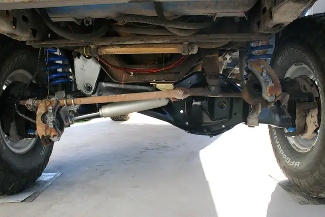

Another options is to forget about the drop bracket and get some cut/turned beams. BTF (vendor here) will make you a set. Its good for 5-6" of lift.
I am running a set of theirs on our X.
Pic of them during installation. I only have 5" of lift and it is barely enough of a lift to get aligned. I'm using stock pivots.
cut & turned - Front suspension shot by maniak_az, on Flickr

Its $200 for BTF to cut/turn a set of your beams... But you have to pay shipping to/from them..
Or, its $400 to buy a set outright from them but you still have to pay shipping to you.
Also, expect there to be cracks on your old beams. Nothing major, but enough that it should be welded up. BTF can do that for you too. no idea what that costs though..
