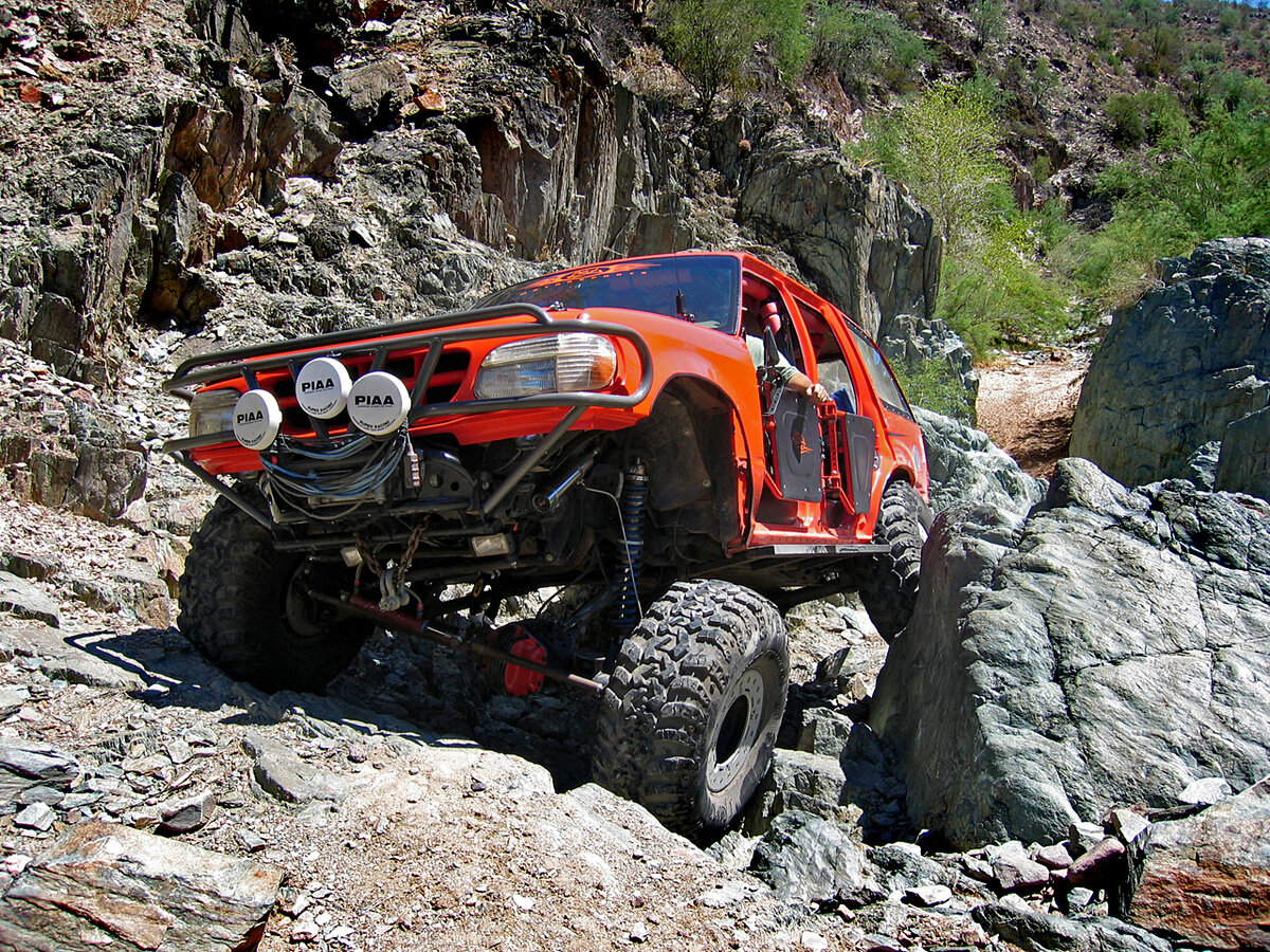

I have been trailering this with out any sway bars on the Explorer since 2000. My freeway speed is 75.
