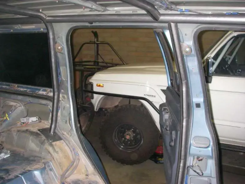

Here's a gutted photo that may help for point of reference.
Thanks abunch DannyBoy! I think cutting that far will weakin the body to much even if the doors were welded shut, so about the other thing your sayin is I could turn my springs around (front to rear) and that would move the axle 3" rearward? Do you think this would also work for a set of the 64" chevy leafs, provided a person moves the mounts in according to the reversal? Also Thanks alot for the pic, this has all been alot of help.
