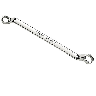

I found that the best tool to use to remove them and reach them is a 15mm deep offset 12pt box end Craftsman wrench (13mm on one side, 15mm on the other). It was the correct thickness on the walls of the box end to get in there. This is what it looks like:
I went through about every set of sockets/ratchets that you could imagine. I also have air tools, everything from 1/4" to 3/4" and could not get in there on the bolts with it. You have to use pure strength to do it. The tapered end of the axle where it comes in from the backside of the spindle, created an awkward area that you cannot get a socket into at all...so you can only get to them from the side. They are too recessed to get a regular combination open end wrench in on.
A tip I will also add, is to simply turn the wheels to get to the bolts easier....I found that I didn't have to hunch over very much to get in on them (once I used the correct wrench on them). Ford puts a yellow thread locker on the bolts, which is VERY HARD TO REMOVE....I had to wrap a towel around the wrench and with all of my might loosen them. So much that they were "popping" as they were coming out, I was just waiting for the head to shear off. I guess that's what 126k miles will do on the drive components! (I'm a 250lb guy who can bench over 300lbs....just to give you a clue of how much strength it took!)

Best of luck to anyone who does this....once I had all of my tools, it was about a 3 hour job for me. Air tools are pretty much useless on this job with the exception of taking off the wheels and axle nut...you won't be able to get anything other than a deep offset wrench on those bolts! Get one...it makes the job very possible!
