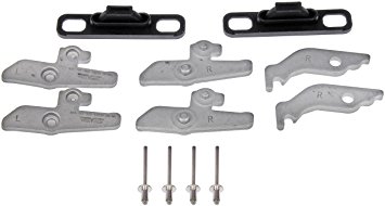

add these parts to be removed. Parking brake levers. When assembled correctly they will be stamped for the correct side, but beware, you can assemble them incorrectly and get the same stamping, which results in them being in backwards.
replacement kits ofr these are available, however they are listed for f150 and expedition. this results in the stamping being incorrect, but, otherwise they will be the same parts. Use pics for proper assembly and everything should go well.
Dorman 924741 is the part number. This is what you get in the box
In my experience and after reading thru this thread, I feel the root cause of the e brake issues are from the parking brake levers being siezed , or in a state of lack of motion. This causes the e brakes to not fully release, and then a chain of problems from that.
Be sure to take pictures of how they are assembled, then remove them, clean the real well with a scotch brite. Use emery cloth and brake cleaner. give them a good polishing, then apply a dab of lithium grease to the pivot nipple. Set them aside --way aside and proceed.
