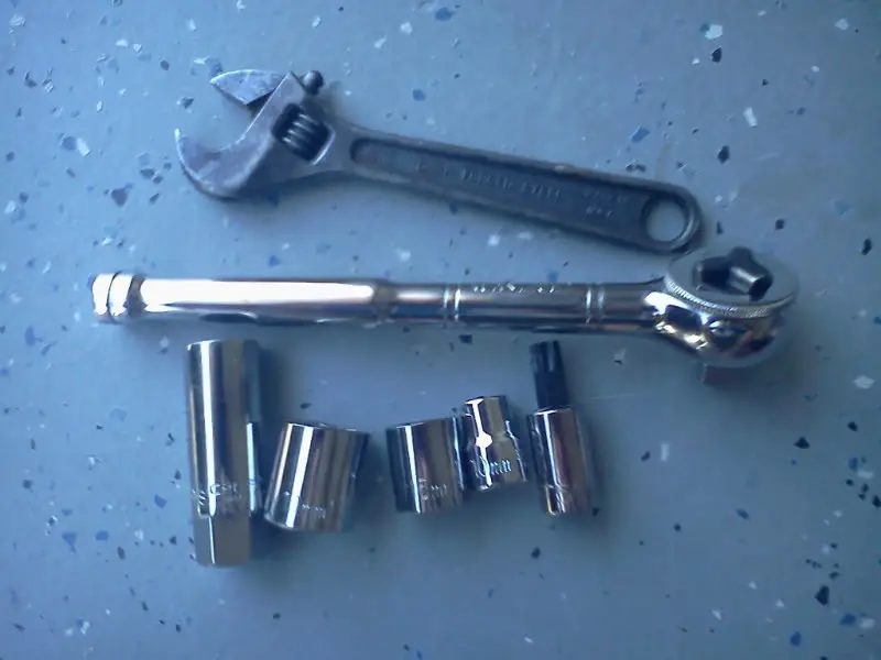

I used a medium socket with 10mm, 15mm, 19mm, T50 Torx and long 5/8 and a simple adjustable spanner. An additional person (but only for 10min or so) is also pretty much required.

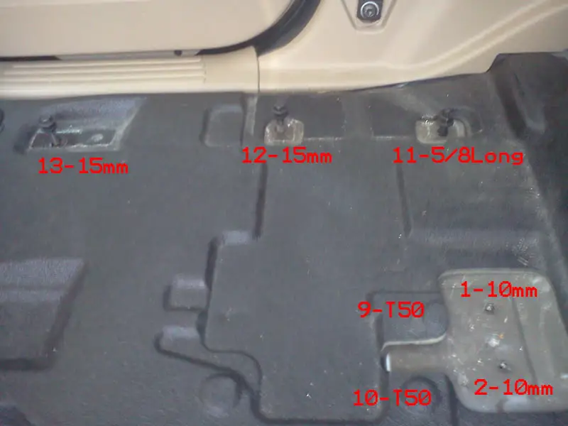

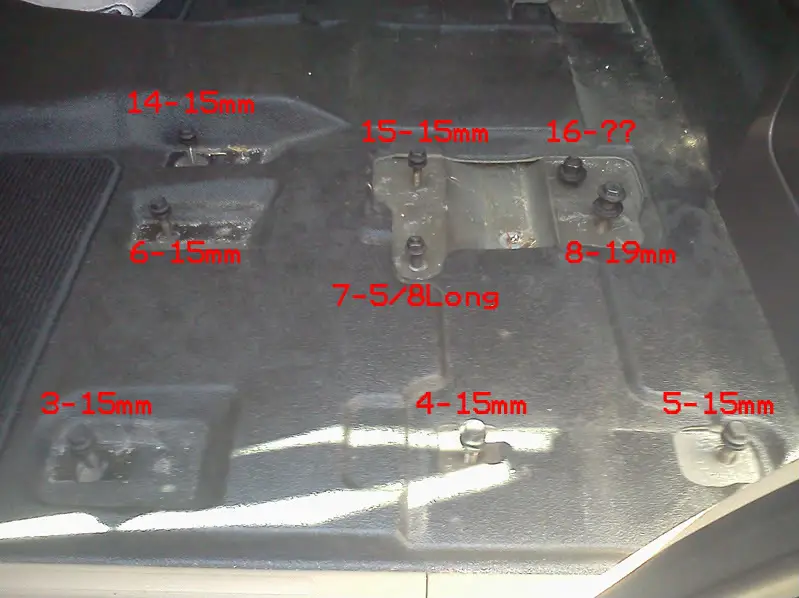

So, in the pictures below, I numbered all the bolts in the order in which one should remove them and included the bolt's size.
Driver side:

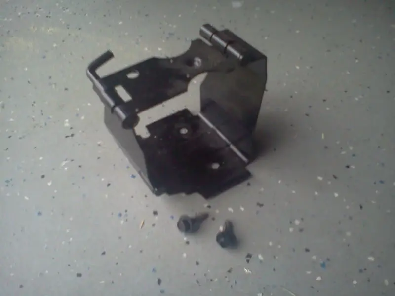

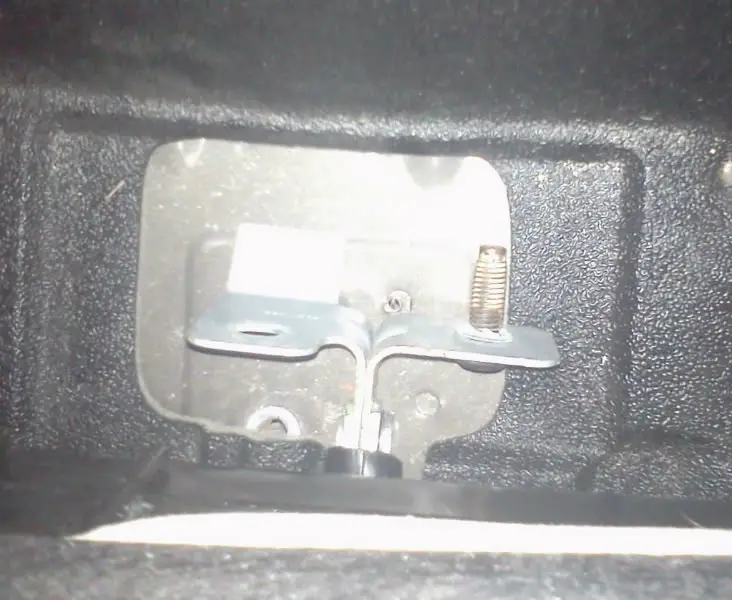

1/2 - First thing I recommend doing is flipping down the bench seat. Then, remove the pin holding the jacking tools in its holder and remove all the jacking tools. Next, use the socket with a 10mm attachment to remove the bolts holding the tool holder in.

3/4/5/6 - Switch the socket to the 15mm attachment and just go at those bolts.
7 - Now switch to the 5/8 Long attachment and remove the nut/spacer combo. FYI - This is the anchor for the seat belt receiver for the single chair.

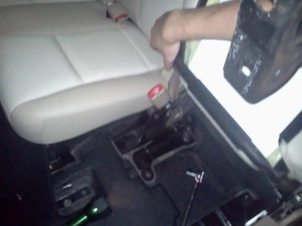

8 - To make access for bolt 8 easy, pull the seat folder release, but instead of the seat flipping forward like normal, use your arm and pull the bottom of the seat up towards the seat back. Make sure to keep the seat belt receiver down so it doesn't get crammed into the plastic molding on the chair and break something.

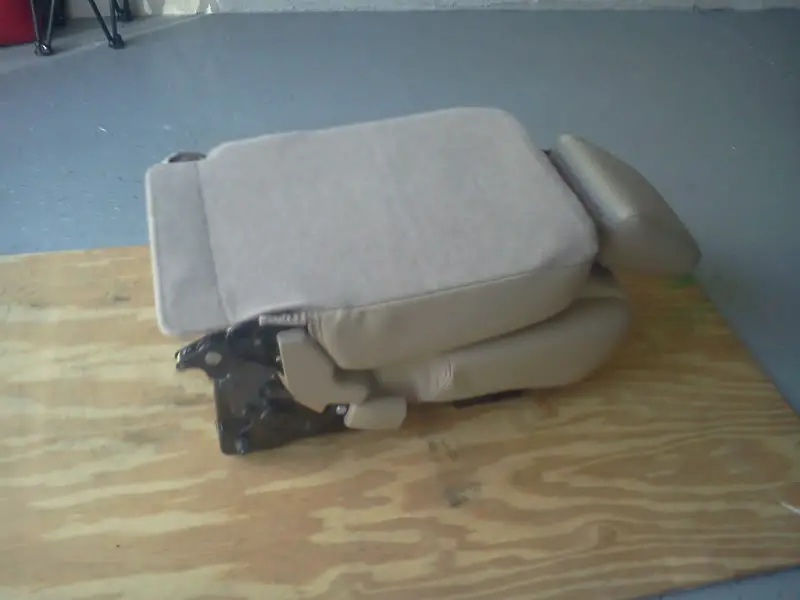

Now, I'd recommend taking out the single seat. This can easily be done alone. Just open your doors all the way, make sure the stands/brackets on the bottom are fully collapsed and take it easy.

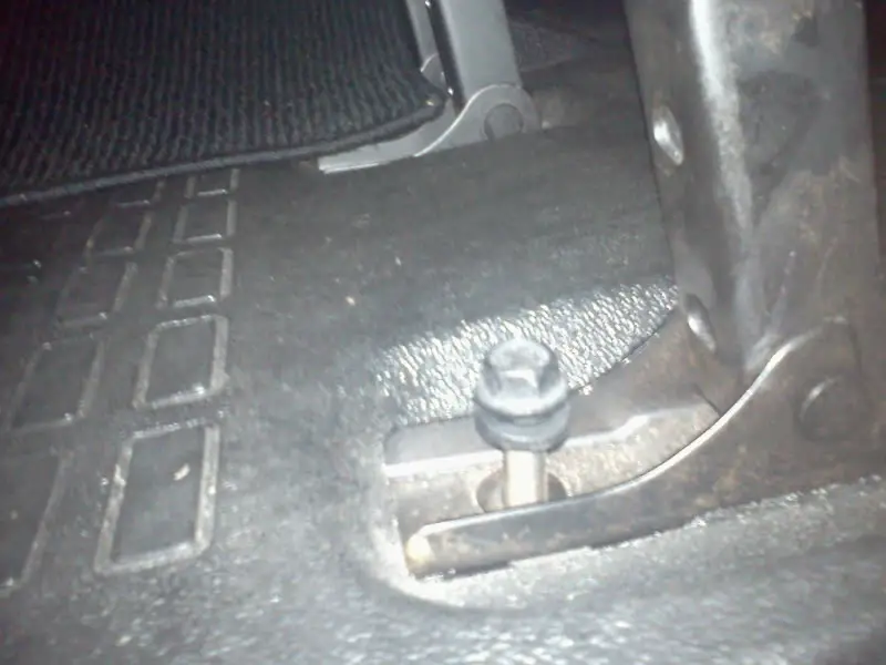

9/10 - Now, go back around to the passenger side and put the Torx T50 attachment on the socket. Now, the bolts are actually slightly under the vinyl floor, so just spread it to the side a bit and loosen the bolts. They will separate from the floor after while, but they shouldn't separate from the seat belt bracket (one of my bolts did, while the other didn't, but they both have spacers between the bracket and floor that should keep the bolts attached to the bracket).
You can see the spacer on the bolt on the right.
11 - Switch to the 5/8 Long attachment and remove the nut/spacer in the corner near the door.
Now put the bench seat back in the upright position to access the remaining bolts.
12/13 - Switch back to the 15mm attachment and remove those last two bolts.
14/15 - Go back around to the driver side rear door to remove bolts 14/15.

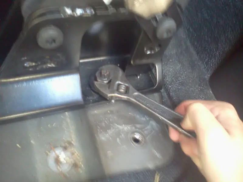

16 - Now, use the adjustable spanner to remove bolt 16. I found that 19mm fit the nut, but I didn't have a long 19mm, so I used the adjustable spanner.
