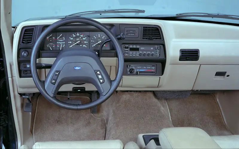

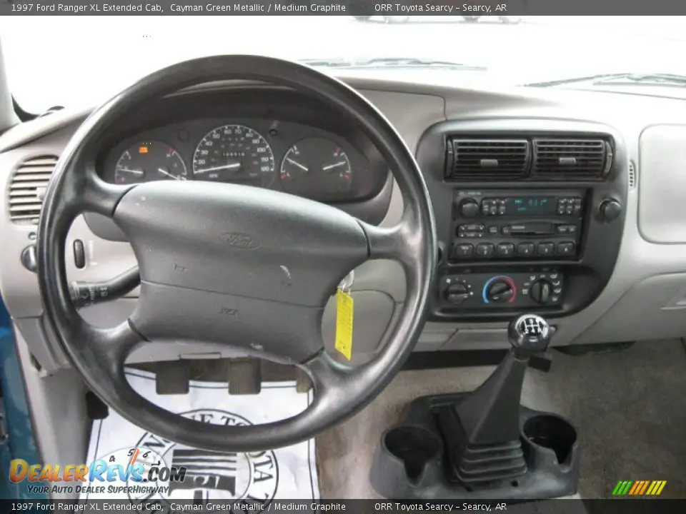

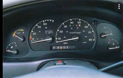

@SVTom I'm not so sure of that. Can you post a picture of your 1997 ranger steering wheel with the instruments in the background. I'm thinking that your dash may look like the 1991-94 Explorers. The 1995-2001? Explorers or maybe later and the 1998 to 2010-11 Rangers dash and steering wheels look like each other.
I will,as soon as I can,but I've bought some switches,so I'll know soon enough.Thank you so much!
If it looks like this it will work
If it looks like picture below it will not
