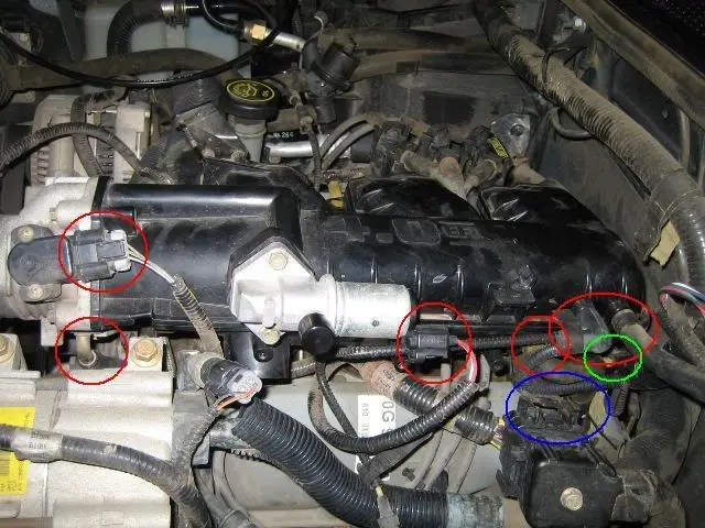

Next, from left to right in the picture below, disconnect the vacuum line to the throttle body, the connector to the throttle position sensor (TPS), the connector to the idle air controller (IAC), the vacuum line from the PCV valve, the accessory vacuum line and then the vacuum line to the brake booster (you will have to use the pliers to squeeze the hose clamp together to remove the hose). Remove the wiring harness plug from the support attached to the intake (blue circle) and remove the wiring harness support (green circle).

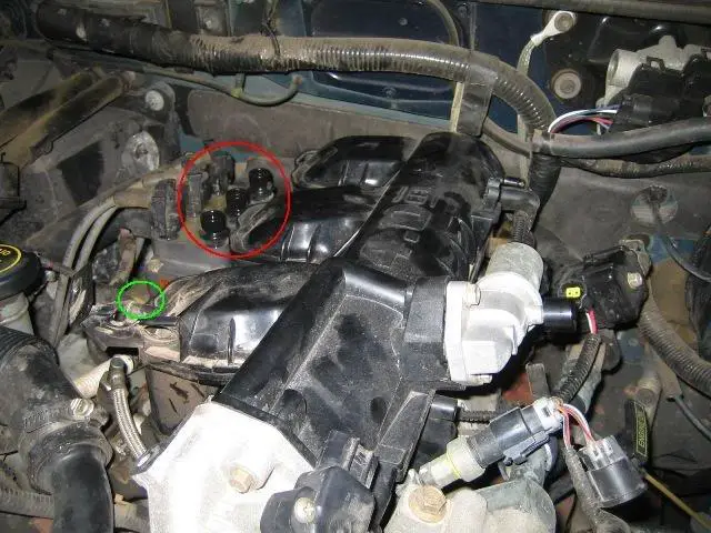

I removed the spark plug wires going to cylinders 4-6 (driver’s side) as the wires are threaded through the intake. I disconnected the wire at the spark plug first, then at the coil pack (circled in the photo below) and pulled the spark plug end through the manifold. Remove the four screws that attach the coil pack to the upper intake. Remove the wiring support for the coil pack from the intake (green circle). Go easy on it, I broke mine in the process :(. Lift off the coil pack and set it aside. I set mine on the passenger side valve cover (refer to the next pic).

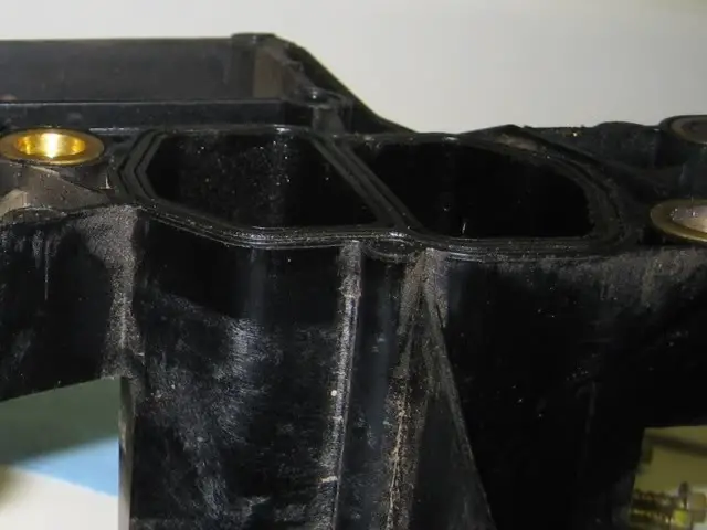

The old gaskets had hardened considerably and were flush with the sealing surface of the upper intake. I can see how this would cause a vacuum leak.

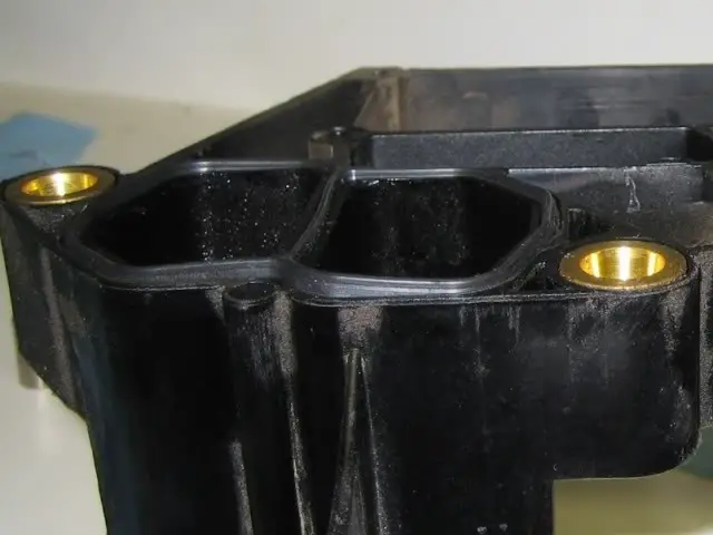

The new gaskets were significantly more pliable and you can see that they protrude below the sealing surface.

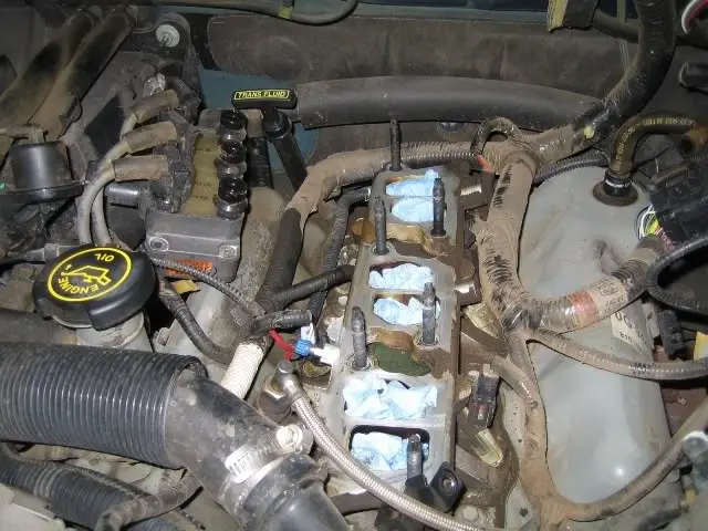

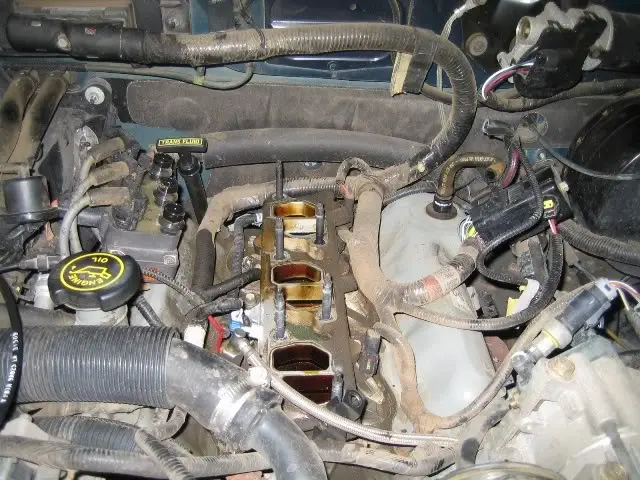

I stuffed shop towels in the intake runners of the lower intake (to keep crud from falling in) and cleaned the sealing surface of the fuel rail / lower intake.

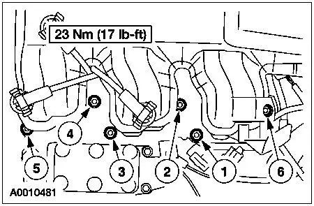

Remove the shop towels and lower the intake down over the studs. Tighten the nuts in the order shown below. I used the e-Torx socket to hold the stud and a crow’s foot to tighten the nut.
