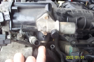

After reading this thread, I sprayed some Carburetor Cleaner in the general area of the upper intake plenum and heard some surging in the engine as I sprayed in different areas (toward the front end of the plenum). Here's some video's of that spraying:
YouTube Video 1 of Carb Cleaner spraying
YouTube Video 2 of Carb Cleaner spraying
I also noticed a long (18") thick rubber vacuum hose that goes from the front of the plenum to an area under the battery. That vacuum hose appears is very chalky and leaves a black powdery mess on your hands when handling it. I am off to replace that this afternoon.
Does anyone have any ideas on the video? Am I looking toward a upper intake plenum gasket leak? Could it just be a fuel injector O ring leak possibly? I can get it smoke tested for $45 but I'm not sure that would be conclusive???

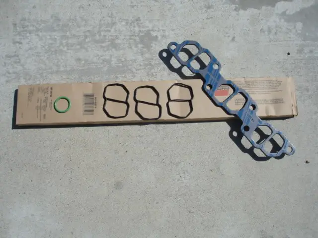

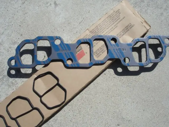

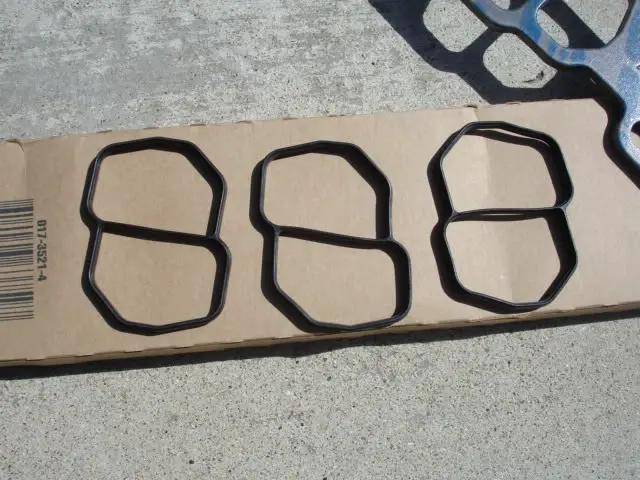

I went and purchased the Felpro Gasket Set, MS 90732.
It came with 3 different items in it:
3 pliable rubber gaskets:
A hard thick gasket (is this what is referred to as the paper gasket? It does not seem paper to me...it's about a 1/4" thick and hard)
and 1 O-Ring
The original poster never mentions the hard, thick gasket? He only discusses the 3 rubber, pliable gaskets.
Also, he does not talk about the O-ring...I know others have mentioned it. I'll go back and re-read those sections.
Question...
After I take off the six 1/2" nuts that holds the plastic plenum cover down, where does the harder, thicker gasket come into play? Is this where the external Torx sockets are needed to take off the six Torx bolts? Is this what is referred to above as the paper gasket??
I don't seem to understand how all these gaskets go back together with the exception of the three rubber pliable ones in the picture. I'll try to document myself when I tackle this job tomorrow.

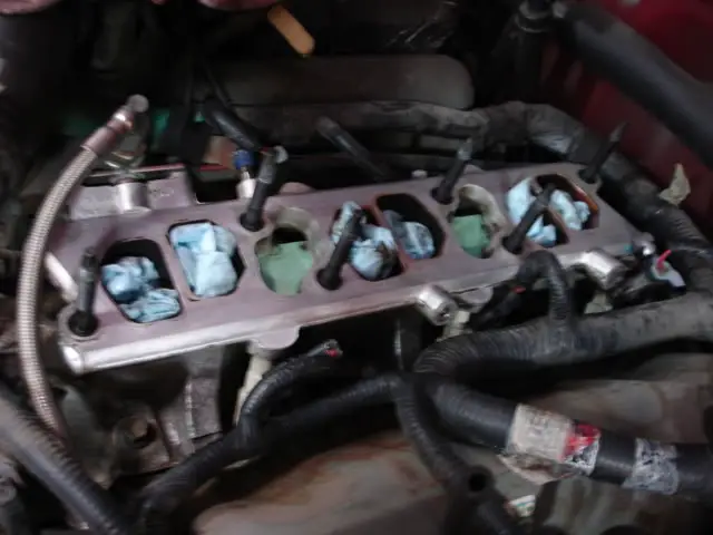

with the plenum off the next piece of metal is the fuel rail, that "paper" gasket goes under there.
when going to take off the egr tube, there is a nut that holds the oil dispstick tube in place, remove that and pull that little bracket up over the bolt, under that bracket is another nut to remove that will release the egr tube. took me a minute to find this but its not too hard. you will need a deep well 13mm socket.
back to the fuel rail, i just took my plenum off and i figured i should replace the "paper" gasket as well since im in there. i was wondering if when this is removed if the fuel injectors will be able to be removed? and if i will need new O-rings for the injectors? should i replace them just for the heck of it since im there?

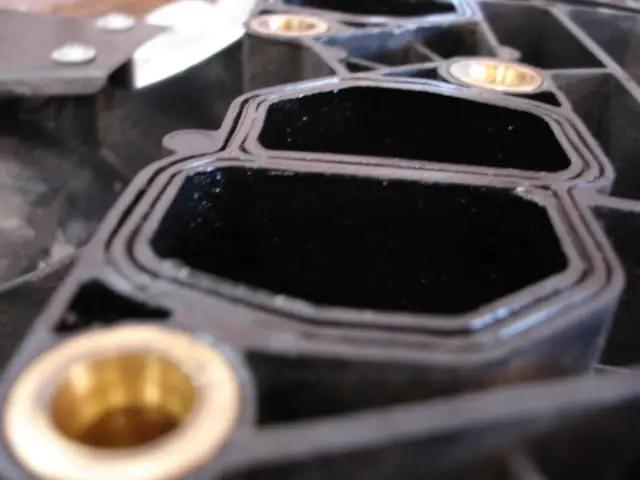

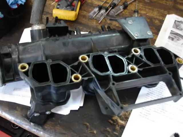

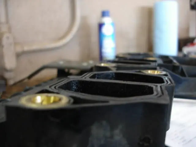

Here's my plenum covers taken off:
Here's pics of the underside of the plenum cover:
The front plenum gasket:
The middle plenum gasket:
The back plenum gasket:
Here is a view from the side of the plenum to see how flattened the gaskets are:

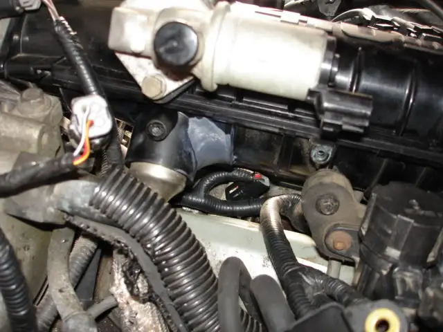

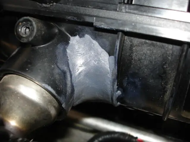

Now, my problem was probably not from the plenum gaskets themselves being flattened as opposed to sticking up a little like they are supposed to from the 1st post...but instead, I found my vacuum leak :scratch:
It was this nice hole near the EGR tube that I found.
It was probably caused when the DPFE failed, which in turn caused one of the vacuum hoses to fail, and thus the hose probably rested on the underside of the plenum. It probably looked like BP's underwater oil leak, pushing hot EGR gases onto one spot of the plenum's underside. The actual hole within the melted outer hole was about the size of a .22 bullet. I could not believe that this hole didn't stop my vehicle completely or that I did not hear the sucking in of the extra oxygen.
Now, I know why, when I sprayed carburetor cleaner near the DPFE that the engine raced some. I was thinking there was a leak in the gasket down below and there was a vacuum leak down there somewhere...I just could not figure out where.
Because I could not go to a junk yard today to pull another plenum, I went ahead and mixed some two-part plastic steel epoxy (1 hour cure time - up to 500 degrees rating) and filled in the hole nicely and made a nice patch.

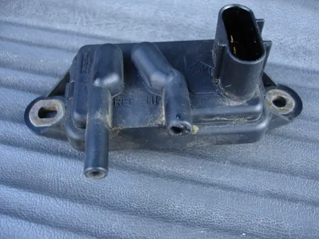

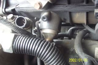

Here's a pic of my plenum repair that was caused when the DPFE failed and thus caused one of the EGR hoses to fail and spray hot gases directly under the plenum...giving me P0171 and P0174 codes:

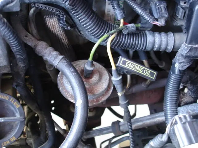

Here's a pic of the bad DPFE that caused all of this...
