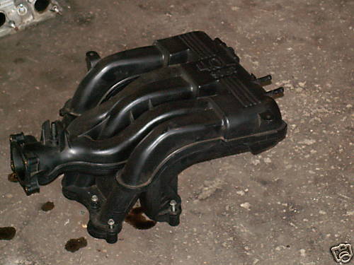

Has anyone ever seen an SOHC V6 upper intake manifold like the one shown in the link below to an eBay listing? It's claimed to be off a 2000 model but mine is entirely different.
FORD 4.0 SOHC ENGINE INTAKE MANIFOLD W/TB #4110

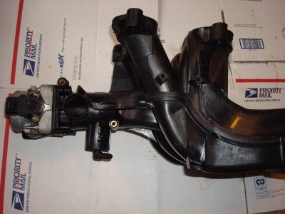

Below is the photo for the listed item.
Thought they were single unit
looks just like the one on my 2004

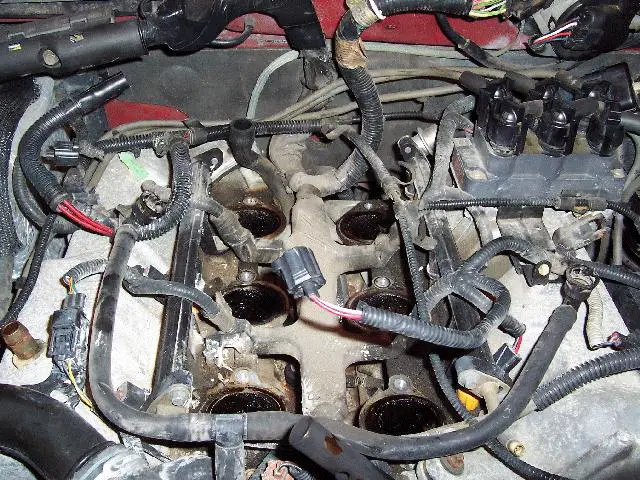

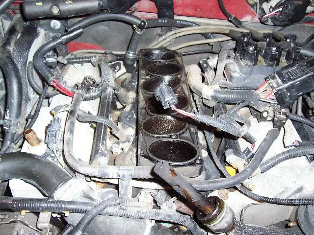

Thanks for the reply. I thought that the newer SOHC V6 intakes were all single units (integrated upper and lower) and the throttle body was at the front instead of the side. Your configuration may be more suitable for some of my planned future projects. It looks like it will bolt directly to my lower intake manifold shown below.

Unless my eyes are playing tricks on me, there is no way that will bolt to your lower intake. Your lower has a single "row" of runner, whereas the ebay manifold appears to be wider, and have the runners in a more staggered "side-by-side" configuration. In addition, even if it's just an optical illusion because of the angle of the photo, and it is a single row, then the first (Closest to the front of the vehicle) runner still appears to be canted at exactly the opposite angle as would be needed to bolt to your lower intake.
Now, if that really is an '04 upper, maybe the 'o4 lower would bolt to your engine?

Upside down
You're right! I was remembering the bottom of my lower intake instead of the top. I should have noticed when I added the photo.

The photo in the first post shows the EGR valve located at the rear just after the throttle body. Does anyone know if the EGR tube comes from the driver (left) or passenger (right) exhaust manifold? The EGR valve on my 2000 is at the front with the EGR tube coming from the driver side exhaust manifold. I would like to relocate it because I need more room near the front of the engine. Would someone please post a photo of their 2004 SOHC V6.

I found the photo below that shows there are individual runners for each cylinder port.
From the photo below it looks like the throttle body may have the same bolt-on pattern as the 2nd generation.
