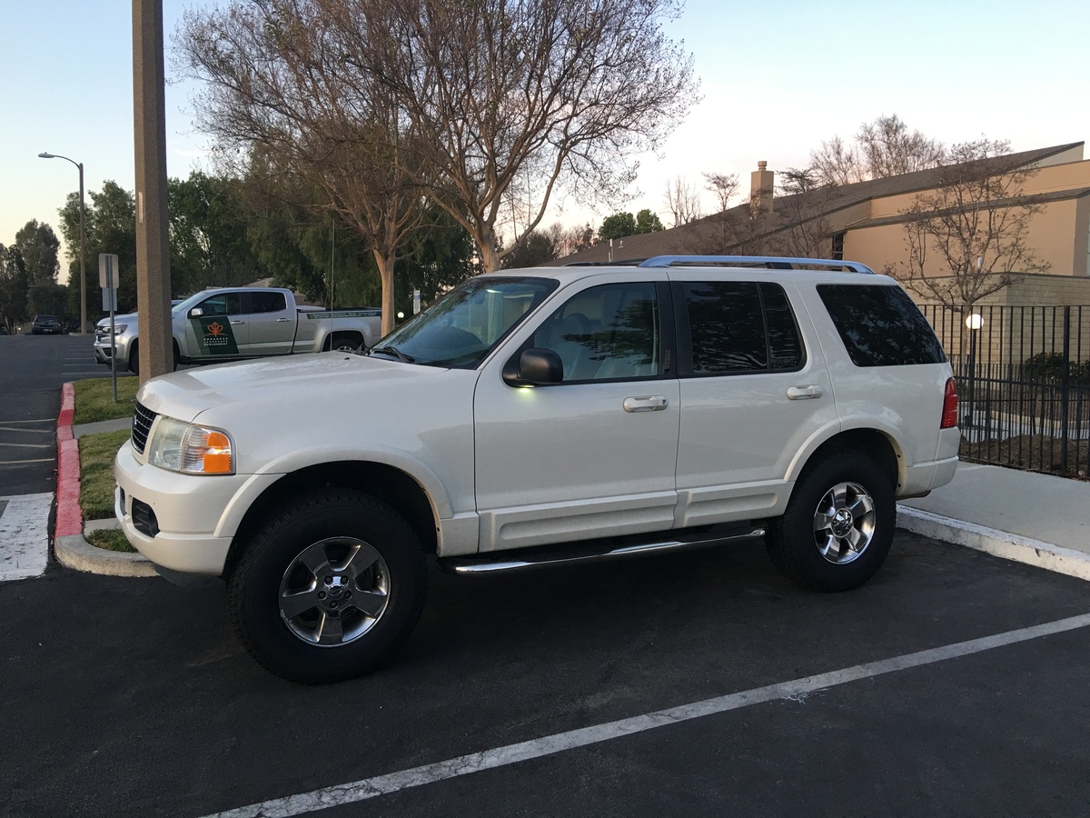

I'm running 285/70-17s (slightly smaller than your proposed 285/75-16's) on my 2003 with the BTF spacers and arms, on stock Limited wheels (7.5" wide). During low speed turns, I was catching the front splash shields (the flexible rubber pieces at the rear of the front wheel wells), so I removed those; they were very noisy. I occasionally clip the leading inside edge of the plastic cladding, at the front of the rear wheel wells. And I rarely catch the inside edge of the plastic cladding at the front of the front wheel wells (rounded them off with a file). If you have an XLS or XLT (but not an XLT Sport, EB or Limited) - in other words, no plastic cladding - you'll have a little more clearance than I do. I'm not running wheel spacers yet, but those will greatly exaggerate the clearance issues, especially when turning, so I'm planning on a 2" body lift as well.
