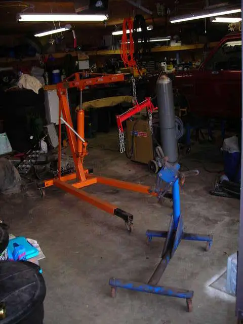

Engine is coming out tomorrow... Thanks to my father in law for letting me barrow the engine lift and stand.
