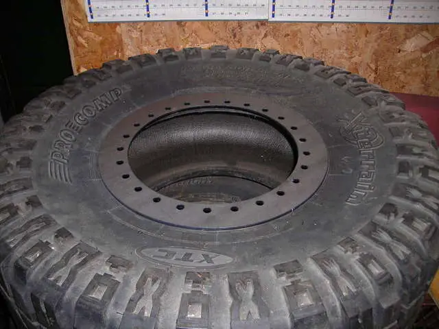

.25" Bead lock rings came in today from my laser cutter. I saved about $100 plus shipping having my own cut rather than buying them. I also picked up some panhard frame mounts from work (with permission from the company owner) they are .5" thick :D.

Got the first beadlock welded up. A sharp eye will notice that it is a dually rim, this is because the front axle has dually hubs on it and it was cheaper to find wheels for it than change or machine the current hubs. I aired it up to 35 psi and am going to check it in the morning to see if it has some leak down.
Weld nuts
Mounting tire
Holding air
