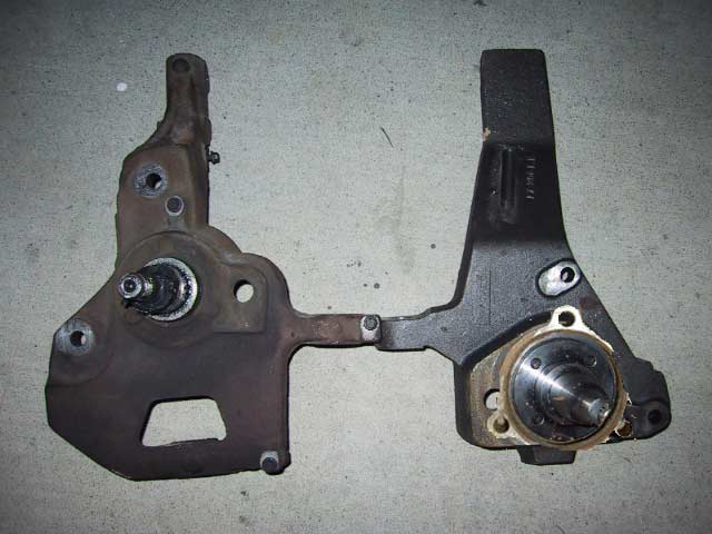

ok so after much thinking and some amount of reading i have sort of a custom 2nd gen front end in mind. since everyone knows that you cant use just spindles to lift the front end of a 4wd 2nd gen, cause the CVs will have a chit fit (plus the fact there is no hole for a CV to go through the spindle). i had the crazy idea of going ahead and getting the Pro Comp spindles and making a hole for the CV and converting everything on the new spindle (using my stock stuff) to like a 4wd type spindle. and then getting the Porsche 944 CV's cause ive read somewhere those will work on a X and can go past the 22* angle that a stock for CV can. am i crazy?
