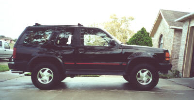

Get 2.5" cat back single outlet with a Flowmaster 50 series (non-delta) and a 3" tip. Get an exhaust shop to fab the pipes for you, don't buy a premade kit it will cost twice as much. I've had guys ask me what size V-8 I swapped in, I love how it sounds. Here's a pic of where my tip came out, I had them take it straight back around the spare to come out behind the right rear tire. Just remember to clean the tip religiously or it'll be rusted over within a year. Good luck
That looks real nice with the 3" tube, do you have a pic of the back of your x with the 3" tubing?
