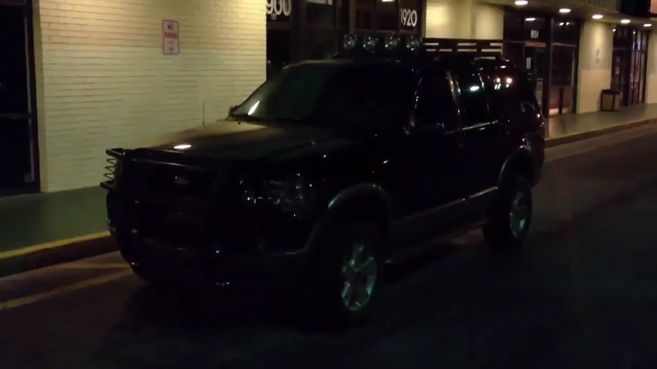

Yup! Here ya go!
I love them! But tons of people flash their lights at me thinking my high beams are on. I re-aimed my lights and they are where they are supposed to be... Is it just me or does this happen to you too?
how....what....no....wait.....did he just....
thats F**king awesome how you wired your offroad lights to your remote start! :thumbsup: :thumbsup:
hid's look good
now make a registry and explain the fancy wire job on those lights :D
i aimed my hids so the shine way down.
form over function - full of win. :thumbsup:
x2
Ha ha I wish I was that awesome. My remote start has an auxiliary line that I could've used. I bought a separate remote for my lights that I can keep in my car and not have to screw with my keys to get my lights on if I need to...
