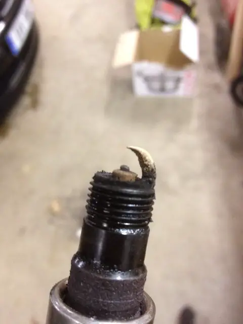

Got the bugger mounted on the engine stand tonight and pulled the plugs. OH MY no wonder it didn't run all that great for the short period I had it running. I assume these were the original plugs. All 6 were very similar. Is this any indication of a problem or just neglect?
WoW previous owner or owners received a compliment when you used the word hack... Welcome Back!!
That is just plain awesome...I have never seen a plug like that.
I am wondering if that is some type of achievement.

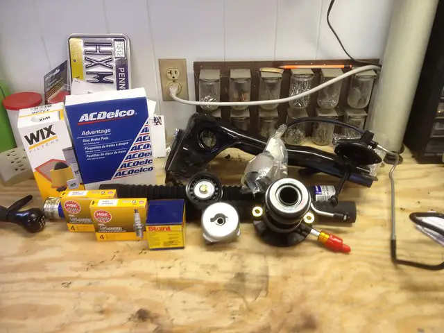

First round of parts came in!
I need longer bolts for the slave cylinder. The existing one has a metal base and is thinner. I'm happy to report my fuel filter pretty much fell out of the quick connects. I normally have to fight with those things.
With that out of the way I can grind out the rivets for the radius arm cross members and get that cleaned up. After that it's time to get the anchor back in the front and get it all buttoned up. It's killing me to take my time at this point but I know getting in a rush will only make things harder in the long run.
If mine looked like yours I'd pop them back in! ;)
It is truly amazing it ran on those plugs.
