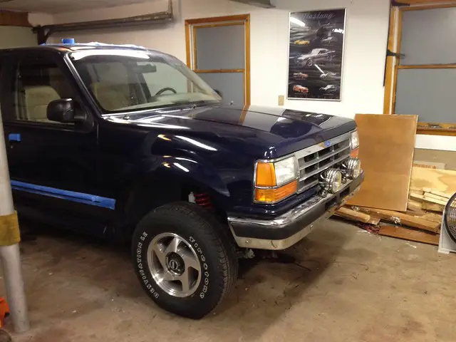

Once again things are making their way back together. I have the beams, radius arms, diff, springs with spacers (wooo lift time!) and shocks mounted up. Need to throw some money towards Rock Auto to get the new joints.
I've also started to detail the horribly scratched paint. Someone decided to spray red paint in the garage with it so it was covered in it. I also sanded off the green pin stripe. Starting to get sleeker! HA! :lol:

Detailing has come along quite nicely. The clear on the hood and roof have had it but the sides turned out great!
Ball joints and in and the knuckles have been reinstalled. All new steering linkage has been added. The spindles have been rebuilt. The snap rings for the axle shafts come today. I'll get the U joints pressed in and hopefully get it rolling tonight.
Shackles are on their way thanks to 99SportX and the add a leafs were ordered this morning to bump up the height in the rear. It's only taken me 10 years but I'll finally have a lifted Explorer!!

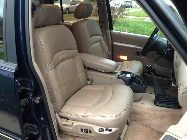

Picked up some '01 Limited seats at the pick n pull. Movement is wired and working. I believe heat is wired correctly. The drivers seat activates but doesn't heat and the passenger side doesn't activate (switched was stuck down so not sure what isn't functioning at this point). Still some troubleshooting to do. Always wanted these though.
The donor has the overhead console, auto dim mirror, and homelink visors that I might get once the holidays are over.

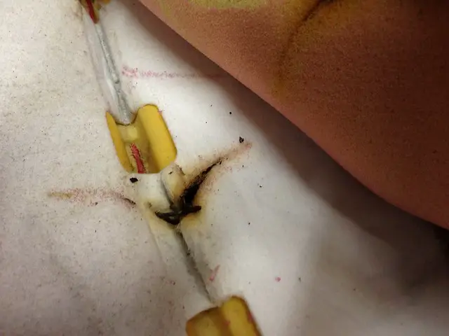

Had to pull the seats to do more work. Both lumbar switches had jammed with the valves open so you couldn't pump them up. Pulled those apart and greased it up. Had a loose wire for the passenger heat circuit. Fixed that and the passenger side had heat.
I had to deskin the drivers bottom to check for burnt wires. Hit the middle and one of the heavier gauge connecting wires was burnt through. Soldered in a new piece and I have dual heated seats now! I must say they get quite toasty. Much better than the Saab go figure. I also like that the full bottom is covered in the heating pad and just not your butt area.
