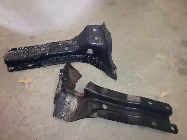

Brackets are off! Took a bit to find the right socket of the arm nuts but once they were off I just put a jack in the center of the brackets and the force popped them off the rivets. Now to get the rest of the rivet out. :mad:
*Note the cut lower one and the worn edge on the upper one due to a bad bushing.

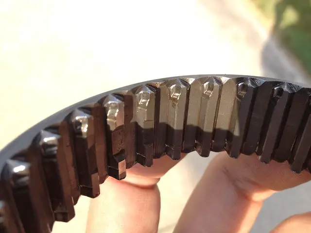

The Explorer has once again assumed the position on jack stands in the garage. Couple issues going on;
Transfercase fluid desperately needed changed, the shift motor lost it's way, and fifth gear troubleshooting.
I pulled the tailshaft housing off the trans to expose fifth and reverse so I can check out the gear and shift fork.
Found an alarming amount of debris in the one area:
Turns out it's what was left of my lower shifter bushing. I'll clean that all up so it's not floating around any more.

After some digging last night I discovered the fifth/reverse synchro hub was on backwards. I have to order a mainshaft and countershaft nut. Once those are in I'll get it back together and she'll be back on the road running slightly more efficiently.

And the official transmission verdict is a bad 5th/reverse slider. It's very worn on the 5th gear side and causing the teeth to slip out. Look like another $70 for a new one and it will be good as new.
Cannot stress how important it is to look over EVERY aspect of every part when it comes to dealing with these gears. I'm only dealing with two, I couldn't imagine looking in the main section.
