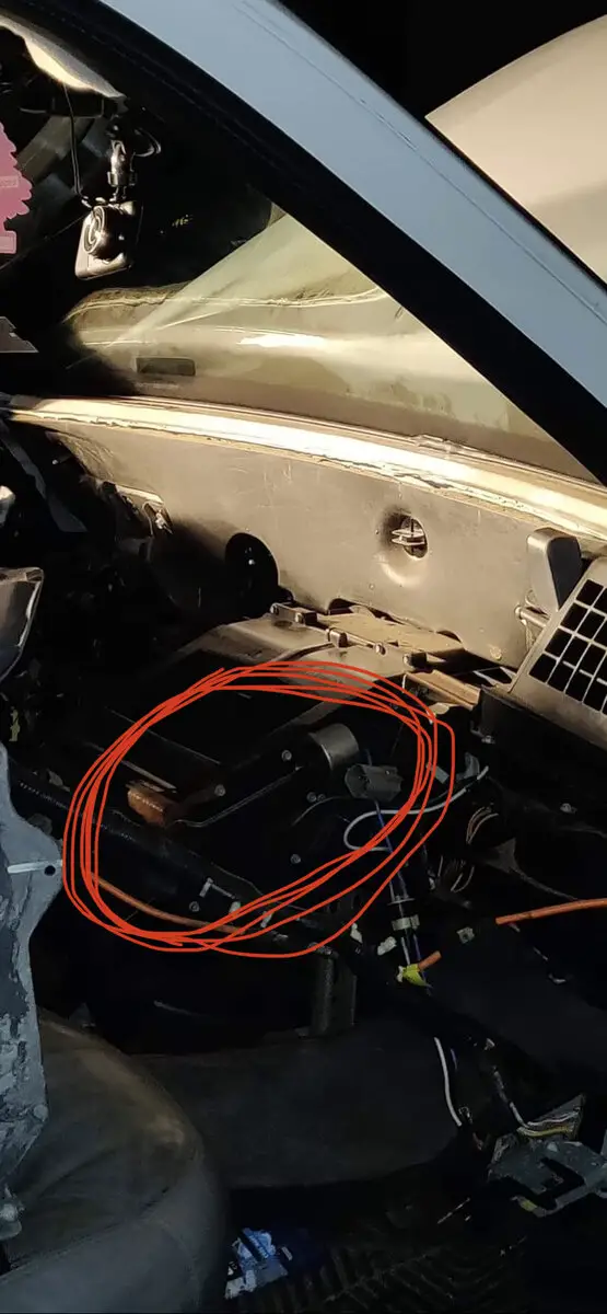

So I have an issue where my vehicle is stuck on the *vents* only. Not defrost, or the feet vents, or anything like that.
Today I tore apart my dash to see further. The common plastic piece visible from the glove box is of course snapped, and the previous owner drilled a hole to keep it in one position. However, I found another actuator doing nothing.
This actuator is visible by taking off the radio cover. Then looking to the bottom right. A black plastic piece was visible stuck on the actuator lever, and seemed to used to be placed in a slot.
