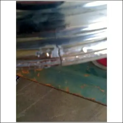

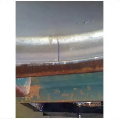

Well I found my slow leak, damn it. Can this be repaired? Im so pissed right now its not even funny. No one in the state of Ga has another used wheel either.

Im going to find out, see if we cant drill a hole at the end of the crack (to stop it) and weld it up. If we can my only concern is balancing it.

That crack is repairable. Crack repair, plus a rechrome, might be costly though.
