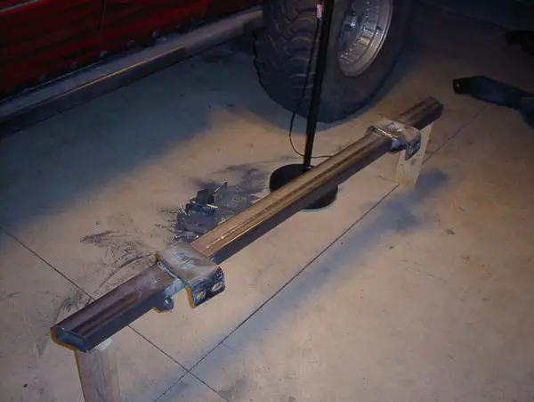

I suggest taking Jefe's idea for modifying the inside of the Ex's bumper
And this weekend I fabbed up all the framework inside the bumper.
2x3x1/4 tube:
mounted on back:
Painting:
Installed inside shell of bumper:
close-up of trailer hitch mount
shows what needed trimming on the frame crossmember
And all done:
Now I just need some hinges and I'll be able to fab up the rest of it.
