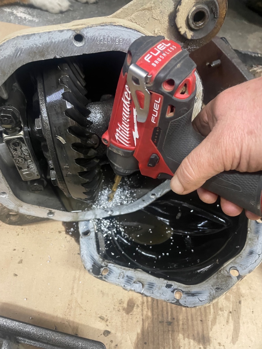

I did

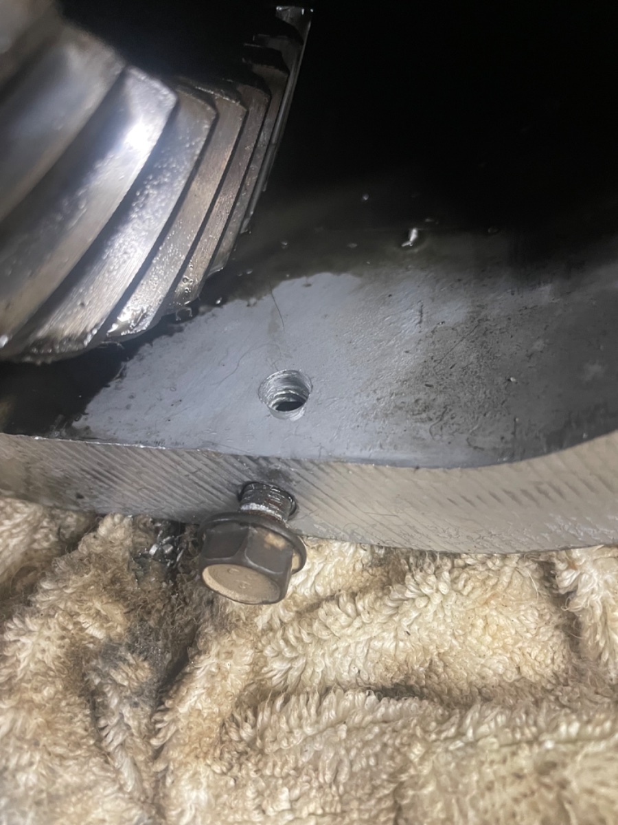

I drilled the bottom hole in my diff and the lowest bolt is now the drain plug
The diff has to be dropped and the cover removed to do this. I assume most of these diffs never get their fluid changed only ever topped off. So doing more then one fluid change is likely not needed for most people. But we are not most people. I keep my trucks forever
That's pretty clever. I like pulling the cover so I can inspect at the same time, but that would be a great trick for a daily driver. With my trail rig Explorer I'll pull the covers about every other year. Same time I inspect the wheel bearings, replace the transfer case fluid, and drain about half the trans fluid and refill. It gets the oil changed every year whether it needs it or not.
