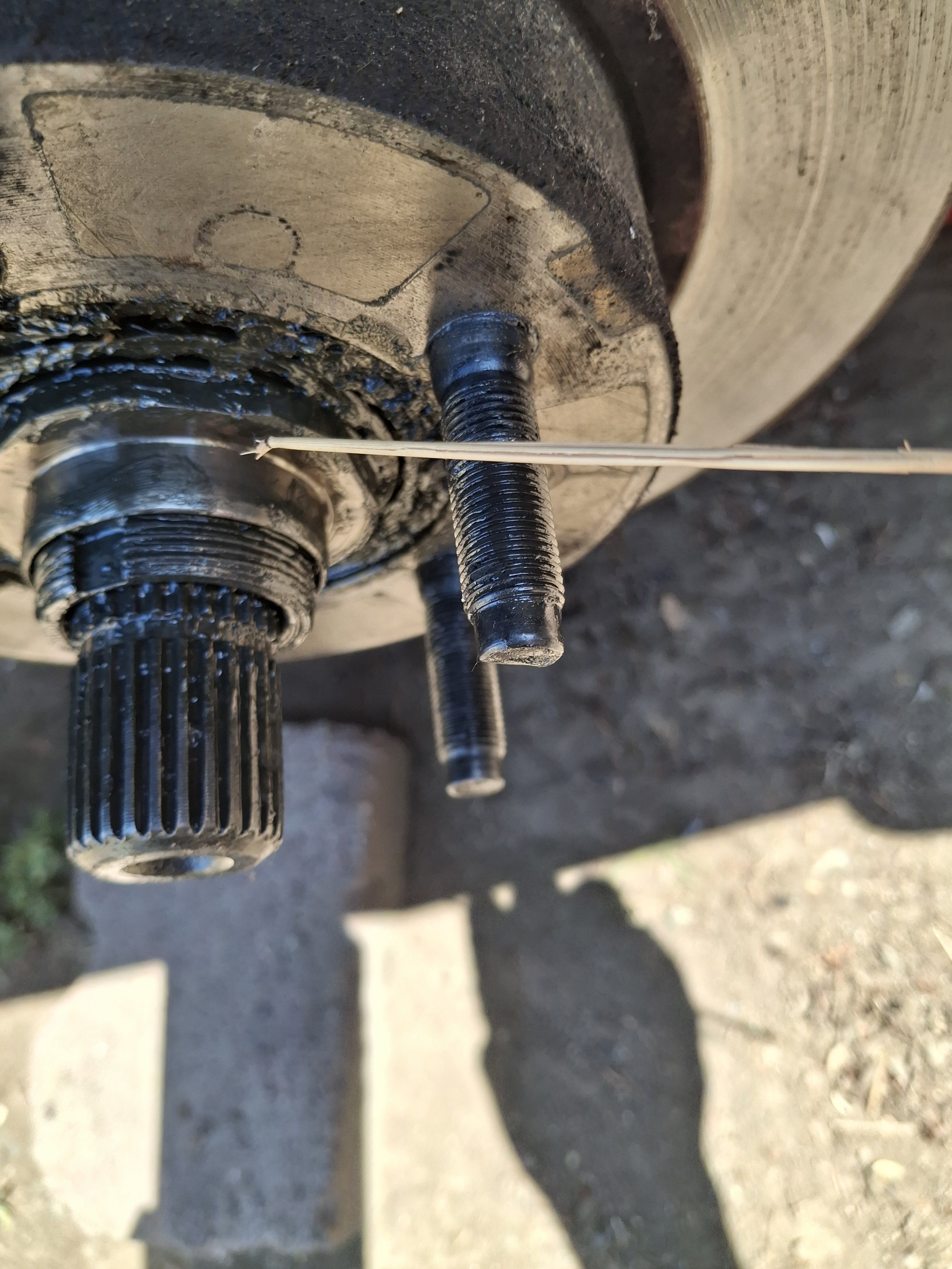

I started removing the automatic hubs and ran into an issue. I posted a pic of a nut. I think it might be the cam assembly nut. It's octagon shape like a nut right where my stick is pointing. Then a smooth flange is thread onto the spindle. When I took the hub off a several parts stayed inside the hub. I don't have a wrench any where close to being big enough to loosen that nut. I was thinking of using a pipe wrench on the smooth section, but if I have to reuse it, it'll be ruined. I figure ask the ones who have done it before for advice.
There should be a flat locking key in the nut inside the cut out part of the spindle. You can turn the nut slightly to take pressure off the key, then pull it out with a pick or small screw driver. The nut is only supposed to be hand tight.
