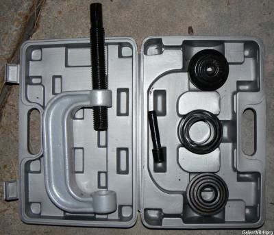

or get this tool and see if you can press it out.
Pic no worky.
Try this tool, many have reported success using it to get the joint out with the axle still in the diff.

(Late add) By the way I tried the U-joint tool and I could not seem to make it fit while the shaft was still in the Diff. Needless to say the u-joint did not get replaced yet. I did however use the tool for the rest of the u-joints and the upper and lower ball-joints. Moving on to the transfer case
