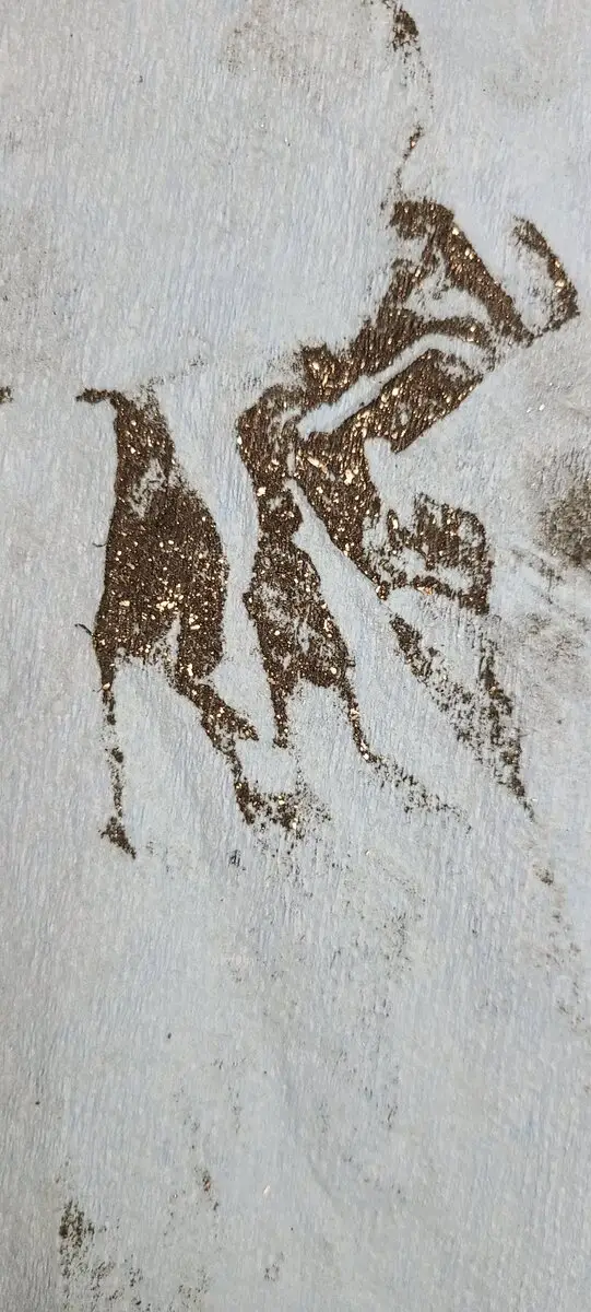

Now I'm really glad I decided to wirebrush out and desludge the interior! It's full of Ford Fairydust! 🤔
It was a thick gelled layer over all the stationary surfaces in there, and it's got chewed up steel flake throughout.

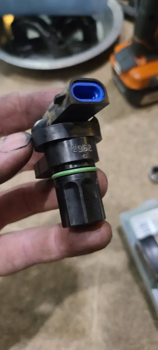

Axle speed sensor removed, cleaned, and new HNBR O-ring to replace the dry and crusty rubber one.

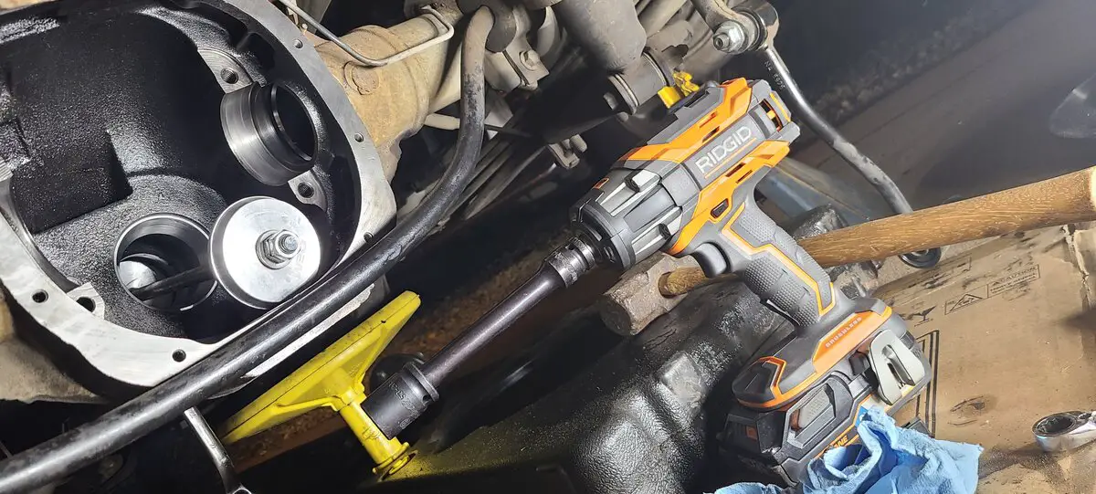

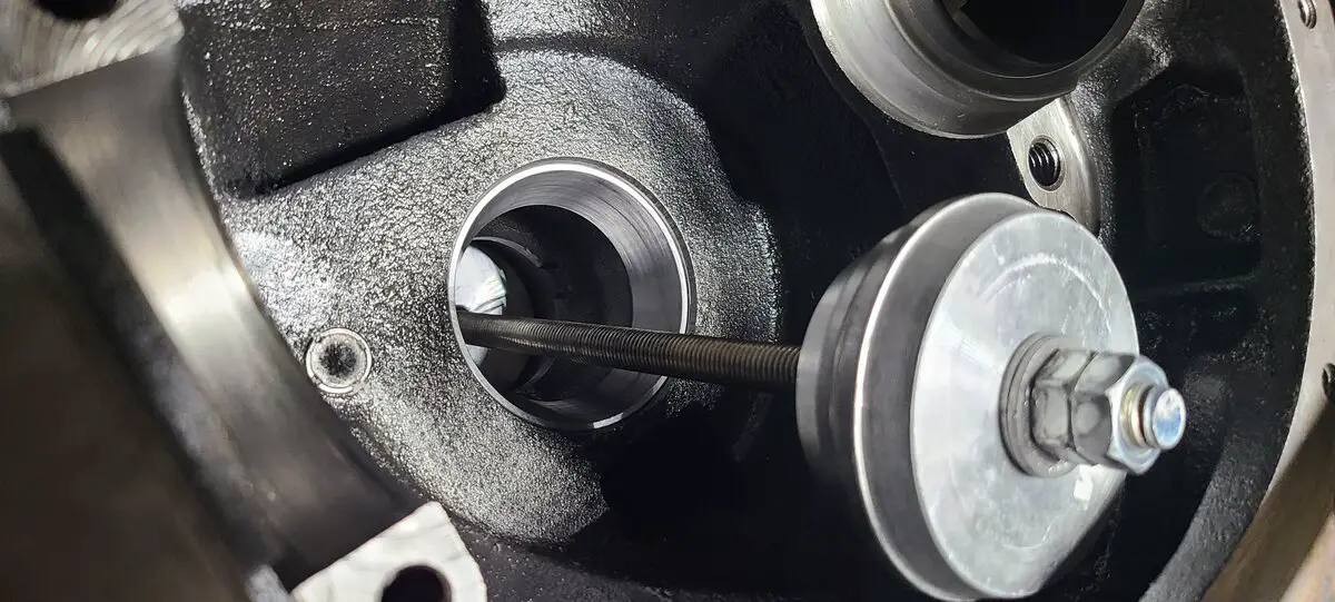

So the rental "bearing and seal driver tool" was total rubbish. Turns out the pucks weren't perfectly round, so the bearing race would go sideways when driving in. Spent the last day or two trying to get it beat in with no luck. This morning before bed i had an idea. Trip to the hardware store for some stainless all-thread rod, washers, and nuts. I used the discs in different positions to better secure the race, ran the rod through all of it with another driver disc at the other end, then used my 1/2" impact tool to squish that dingus in straight! I'm going to have to remember this trick.

I used a piece of brass round stock
Tap tap tap
Looks good !!
Good idea! I’ll have to try that

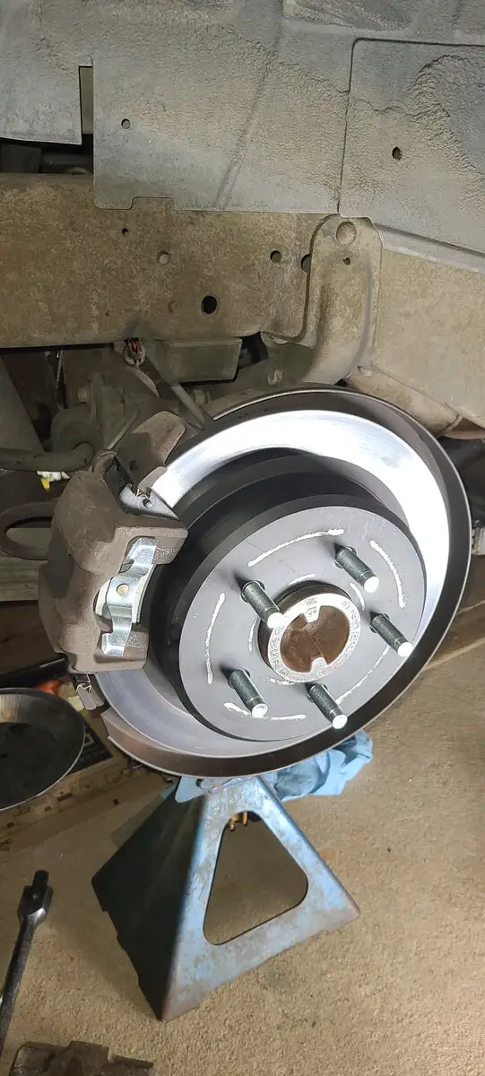

Still making progress. Managed to get the pinion depth set, nailed the crush sleeve/pinion preload on the first shot (😮!) backlash set, wheel bearings and axles in, new wheel studs (one was snapped, so didn't trust the others) brakes on... there's just the tiniest bit of in/out play in the axles now, about 2mm. MUCH better than before! The old shims on the diff were allowing the entire diff carrier to move side to side so my play used to be more than .25". Gotta wait for the RTV to cure before I can put in the juice, but things are looking good for a morning test drive/low speed break-in.

Well done, that's a great feeling when you have it all finished and know it doesn't need anything for years now.
Old diff had so much play, you hit the gas and wait for the rear end to catch up. I also agree it is a great feeling when the project is completed and everything works exactly as it should for years to come.
