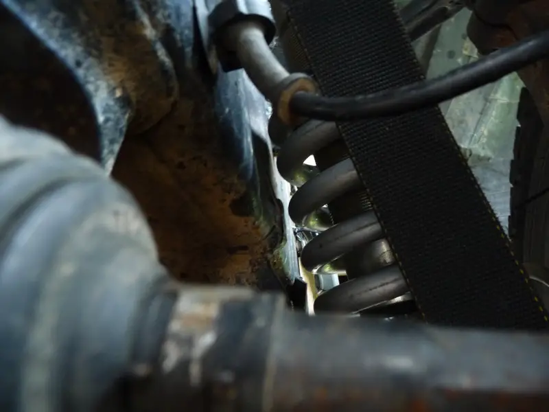

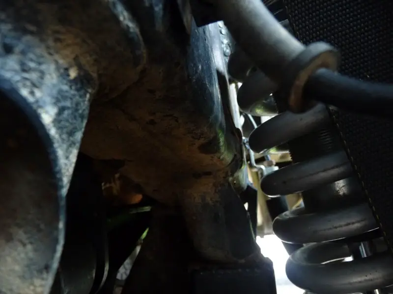

Coil Clearance (Frame)
As you can see they are pretty tight. But whats nice is they are actually lined up neatly inside of the shock pocket that is molded into the frame work.
Sorry this took so long. Work has been nuts.
i have plenty of clearance from the frame on mine but uca's are very tight, I dont think i can get any more lift from these compared to the torsion bars but gosh they ride like a dream and look great! im maybe planning on a spindle lift but seems like too much work, but i dont know yet im just enjoying them right now lol. any other questions or pics just ask and i have pics up on the lifted sport trac thread
