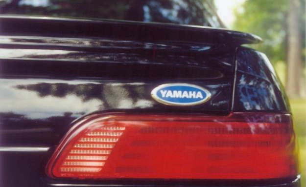

What the HE11 is that? :eek: Are you Communist?
How could you do that!?!
What you dont like the idea that it is a Yamaha powered Ford sedan?

First of all you don't have a Yamaha powered Ford.
Second of all Dead Link Removed NO I don't like it.
Have some pride in your country man!Dead Link RemovedDead Link Removed

Actually... Yamaha did build the engine in the SHOs.

B94Sport your right, but then Ford had to mess it all up by trying to copy Yamaha's design with there Duratech engines. Instead of just coughing up some extra dough and having Yamaha improve on a 13yr old engine thats been out since '89 with just new cars starting to catch up to Yamaha's great build of this engine.
Hey BlackMagic dont get mad at me because Ford had to contract an import company to build them an engine that wouldnt blow head gaskets like the beautiful 3.8L Ford makes.
