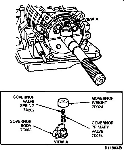

Already been to the dealer, they said they couldn't get it any more as it was discontinued.
Try WITTrans.com. https://www.wittrans.com/Schematic.aspx?Transmission=A4LD/4R44E/4R55E/5R55E
Governor part numbers can be seen on the packaging in the governor replacement thread on this board. Dealer told me a couple original P/Ns were superceded but the replacements were also discontinued. DSM shows:
Governor body: 7C063
Governor primary valve: 7C054
Governor valve spring: 7A302
Governor weight: 7D324
Governor body counter weight: 7F124
