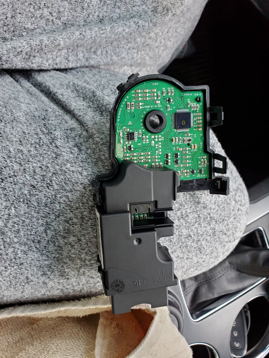

Thank you! Lol I'm typing and frustrated at the same time that I didn't even pock that up lol. When you pull the black piece of from where the motor is there is a green computer card inside.Welcome to the Forum.

I would think that in this case that the motor for the glass partition is no longer working. I'm not sure what you mean by "monitor card". It's the first time I've read that phrase. There are 2 motors, one for the glass and another for the shade. The reason the shade won't completely close is that the moonroof is open in the tilt position.
Please report back after you checked the fuse. Thanks.
