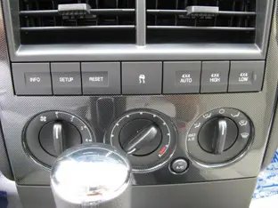

If it is a 4WD model it will have these buttons.
"4X4 AUTO" means it is in rear wheel drive until it senses slipping, then it will automatically go into 4 HI
"4X4 HIGH" is typical 4 HI, front and rear are locked
"4X4 LOW" is your typical 4 LO
AWD models will not have those buttons.
