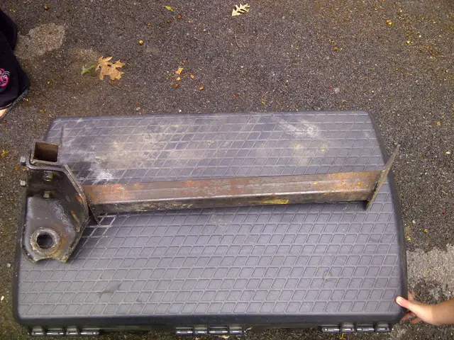

Here is the cross member I made for it before I extended my radius arms and went with ballistic joints

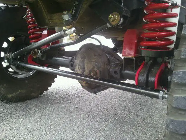

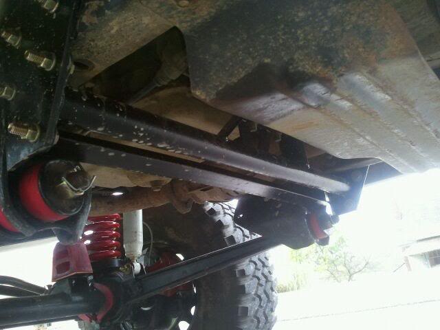

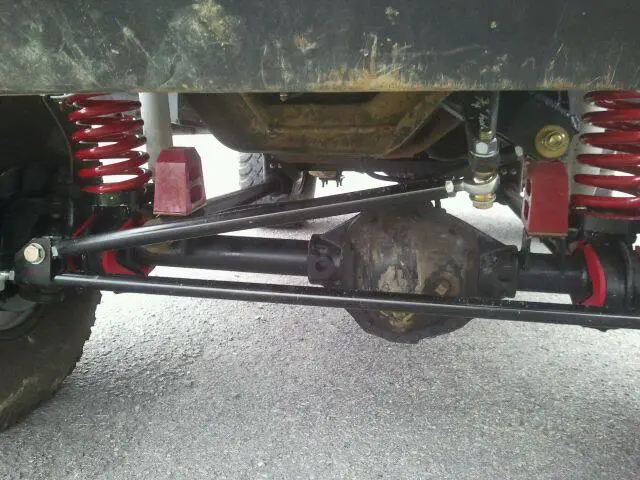

need to set the toe tomororw and the camber is way off, gonna call a friend at an alignment shop monday to see what he can do with it. only thing suspension wise left to do is make a tie bar for the radius arm brackets then check everything for clearance and make sure all the bolts are tight then I can drive this hunk of junk

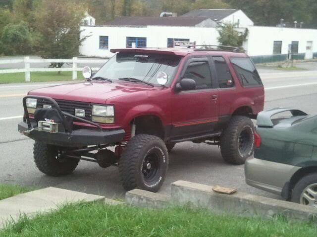

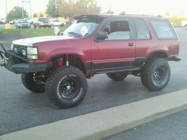

ITS DONE! ..mostly
putting miles on the gears, have the front driveshaft out, going to put it in later this week and check the trans crossmember for clearance.
that looks awesome!
I so want to do mine now
thanks!
it looks like thee truck sits higher in the front.but its actually level until I put gear in the back but the front coils will.settle.some.
it drives great minus the body roll from the soft coils. I need to find where I put my sway bar.
Job well done! Another project I can drool over until mine.
