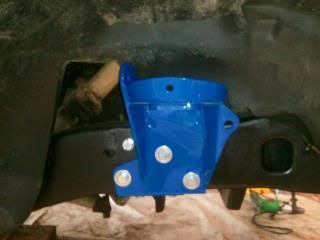

duff sas bolt on coil buckets, all hardware, 2 duff shock towers 270 to my door. universal buckets are 120, shock towers lets say 30-50, and id have 30 in grade 8 hardware so its not THAT bad. now i need to sell some more junk to recoup my budget for the steering.

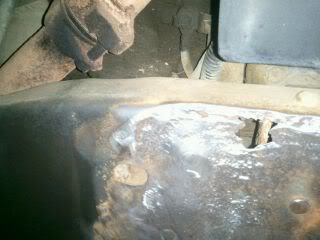

if they make it in by friday.. and the driver side frame doesnt have a surprise hole when i take the factory bucket off.. you might be able to see how it looks bolted up. I am a procrastinator, although with all the stress from this work week i'll be needing some garage time to settle myself down.

wasnt able to get much done this weekend, worked saturday and had to put front pads and rotors on the Ranger. i was able to get the radius arms sandblasted and painted after getting the duff coil buckets installed.
