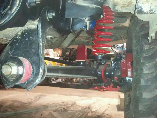

just a small update... got to work on the truck last night. thought I'd 'quickly' install the duff sas track bar bracket. after an hour of cussing and grinding in the engine crossmember for clearance its in. will try to get a pic up later. looks good fits nice has the center point of the bushing sitting right on the outside of the frame rail

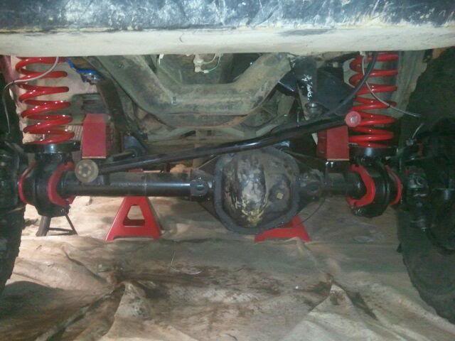

shocks towers mounted, axle lined up

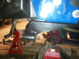

I'm on a deadline so i cheaped out (for now) and 'modified' the factory trans cross member to work

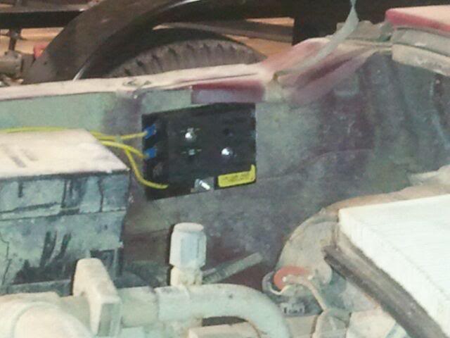

Also mounted an aux fuse panel and re-wired the fog lights in my grill. Had the 5.5 wildhorses coils in and the truck would have been too high for what I want right now. Hopefully the 3.5" coils I ordered will show up in the next couple days

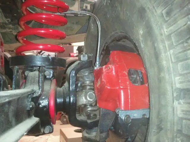

got some more work done this weekend.. calipers are on, flex hoses installed, front brakes bled, measured for steering and trac bar, and taking a little time out to re-do some accessory wiring that over the years has become a tangled mess.

havnt updated in a while so heres where I'm at in a nutshell..
ordered the steerin from James Duff, measured exactly how they told me, drag link was 2" too long, customer support said 'thats what happens when building a custom steering setup 1500 miles apart' which really bummed me out, cause before that the service was superior to anyone ive been dealing with. so had a friend cut an inch off each end, took it to a chassis shop to get it rethreaded, brought it home, burs on one side and i cant find a tap in this podunk town to save my life. so the front is done minus lining up the drag link and welding the saddle bracket to the tie rod.
I had ordered the WH 3.5" coils for fear the 5.5" coils would leave the struck sitting way to high after reading that most net ~8" with those coils. Installed the 3.5s and the spring rate just wasnt enough for the weight on the front of the truck from the bumper and winch. so i went back to the 5.5" coils and the truck is nearly level with the rear lift springs and shackles.
in the mean time the rear is together minus shock mounts, finished up the accessory wiring, still need to figure out why my trans temp guage stopped working, cleaned the junk out of the interior, started looking at some ideas to mount the high lift. got the rear bumper back on, need to find a single 5x4.5 to 5x5.5" wheel adapter for the meantime so i can keep a spare.

I maintained use of my OE trans cross member while using 78-79 fullsize radius arm mounts. Should I tie the mounts together or can I leave them how they are? My only concern is the frame flexing.
Thoughts?

I tied mine together.
