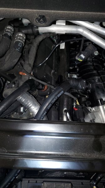

Quick easy mod. Crank case line could be a hair longer but it's whatever.
For the scaredy cats, literally grab the OEM line after the intake connection and pull up towards the hood and kink the line to rotate it towards the front of the vehicle to access the tab release safety. Easier just after the vehicle was driven so the line will be softer.

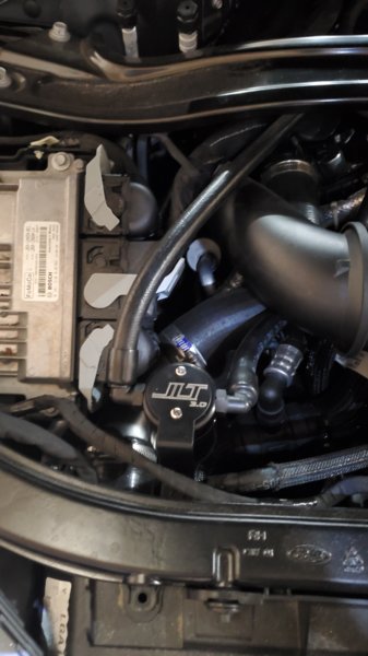

Anyone know if JLT is working on a drivers side can or one is needed?

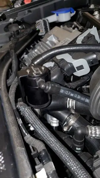

Received mine today (shipped to CA via FL) and the install was surprisingly easy, except for the part where I dropped one of the screws into the engine bay. Oops! Was able to recover it by crawling underneath and taking off the splash shield (which was considerably more work).

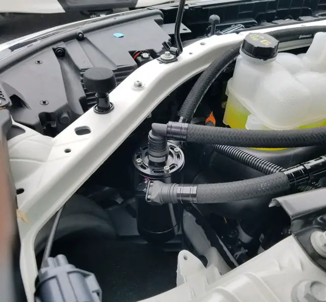

Did you get any of the extras like the drain hose or the high flow check valve? Nice unit but pricey.
I got the check valves just because it’s an added security with boost.
they are pricey but the components are first class. And continental hoses aren’t just better quality they look 100 times better in the engine bay.
