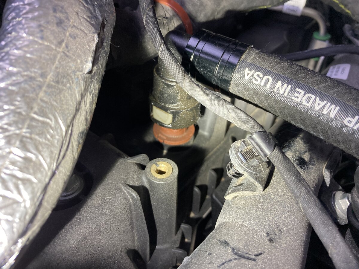

Good afternoon all,
I didn't want to start a new thread and thought that there was a good chance some of you may have an answer for me. My question is in regards to the Dirty Side PCV connection… I emptied my catch can the other night and when looking to make sure all the connections were good and nothing was loose, I observed that the Dirty Side PCV connection had oil residue on it (looks like it has been sweating). All the other connections looked good except for that one.
Is this something normal? or could it be a defect in the connection at that end of the 35 inch hose? If this makes any difference, I have the 2 UPR Billet Pro Series Check Valves.
Thanks

Some weepage is OK but it sounds like something is seeping through the seals.
BTW the 2.7 and 3.0 EcoBoost motors have oil separators built into the valve covers for both the PCV side and the cleanside. If you look closely at how the valve covers are formed, the connections at the valve covers go into a series of channels/voids that helps separate the heavier oils. Most of the time the stuff that collects is condensed vapors from hot/cold changes in temperature. My 3.5L EcoBoost in the SHO had a separator for the PCV from the factory, and the only thing the JLT collected was volatile vapors and water during the winter and not a single drop of oil.
I drilled a weep hole in the intercooler for my 2.7 EcoBoost and some oil comes out of it. That's usually from the turbochargers themselves, and no catch can will catch that.

That's what I was thinking too. Question is, seeping through the PCV or the UPR hose... I'll keep an eye on the connector

Sorry for the late reply, I just wanted to make sure the check valves are facing away from the catch can towards the engine and that you do not have the line with the check valve connected to the PCV. As that is very uncommon to see any type of collection of dirt where the fitting has a bit of oil on it. We offer custom sized hose ends as you can see that unit has a two stripe hose end and we offer hose ends for $9.99 and if you already own one of our kits you can get a tighter three stripe for $4.99 us anytime. Also, you can remove the fitting and trim an inch of hose off and then reinstall the fitting to get a fresh clean bite. As long as you have the ability to pull the hose an inch closer and trim it you can adjust it very easy.
Hope this made it easy for you to adjust or figure out, Joe
