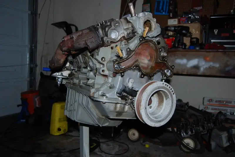

so whats next? (after taking intake/heads off) take off pulley then the timing cover?
I'd take that Crank sensor off and stash it before your do anything else. Don't want to damage it.
Then I'd say try to pull the crank pulley off, gonna need one helluva impact gun or breaker bar to unbolt that thing off.
Yeah, that thing broke one of my Craftsman impact sockets.. I had to use a Kobalt 1/2" impact socket on a huge breaker bar with a piece 3/8" walled pipe as an extention... oh and the truck's starter helped somewhat.. ;)
lol. just like staples, that was easy! grabbed a 2ft breaker bar and a 1/2" 3/4 socket and the bolt came right out!
but the pulley is still on there, how does it come off?
lol at me using man power to get it off and you needing to turn over the engine. but you are superman with valve cover bolts tho! :p
you need to buy or rent a balancer removal tool
lol no wonder i couldnt find one, i was looking for a crack pulley puller. shouldve been looking for harmonic pulley puller. ill get one today
a crack pulley puller? something you should be telling us?
If you can't get a hold of a harmonic balancer puller then an Olds err Pontiac (forgot what Autozone rented it for) steering wheel puller works.
crank! not that theres anything wrong with :mattmoon:.... but thats meant for another thread somewhere else... lolol

Make sure to get a new bolt for the crank pully if you don't have one already...it's a TTY.
ive heard that but not till i used the old one again,but i havent had any problems with it
my plugs came from ohio. was the $8 heavier or was it shipped ups?
problem is 2 things were at the summit warehouse. the rest are being forwarded to the manufactuer and shipped from there, so it makes a lot of packages :(

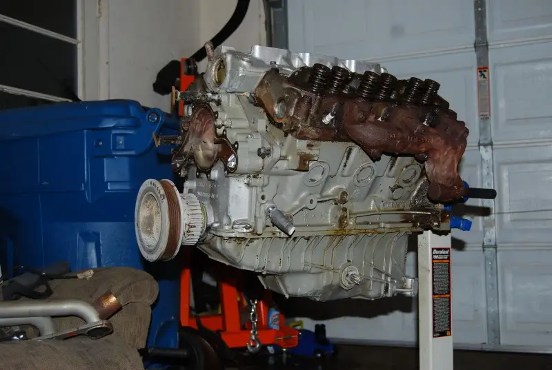

it did get clean, mostly the dirt thats left i didnt even see until the camera flash lit it up. and some was in cracks(lol) that i couldnt get to. there seems to be some surface rust spots on it tho.
ill have to think about a new bolt. whats tty?

piston rings: standard or due to wear am i gonna need to measure for oversized on that too?
and the headers i have. you can see what im talking about in the first engine pic above.
but the flange is to far back and the pipes stick out, not flat, so it wont sit well on the head and the gasket doesnt fit either cause of it.
sand the pipes down even with the flange?
