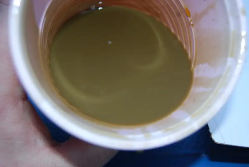

also the oil on the rockers and on the plugs on the heads looks like normal oil but brown anyway. the oil i drained from my oil pan resembled the color of this stuff, just not as thick as this, but was a little more green.
oil pan:

well the valve stem seals are why i opened it up, installed wrong. putting oil on my plugs and giving me a bad idle. im thinking fuel is hitching a ride on the valves up into the head and into the rocker area making it seem like coolant mixing but its really fuel.
i do not smell coolant, it really does smell like fuel to me

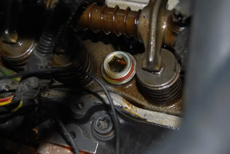

you can see in the last picture of the rockers, the rockers and the hole in the head plugs have brown oil on them, but covers and pan gives me this crap. its confusing me why theres 2 different looking oils

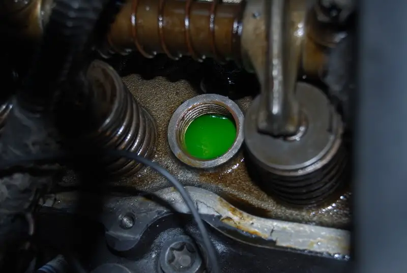

i checked those plugs in the heads, WE FORGOT TO TIGHTEN THE PASSENGER SIDE ONES! I UNSCREWED THEM BY HAND!!!! :( :( :( :( :( :( :( :(
didnt take any effort to turn them either, completely loose but still enough to stay on this whole time

i was loosing coolant... but it was very little at a time. just so happened i reconnected the heater lines and it dropped, used the heater and it dropped, then filled it once more after that time. last few were overflow tank only. so i never thought of it being this, i jsut thought it was from using the heat
my coolant seems fine, but my oil is shot judging by the crap on the valve covers. so seals, pushrods, tighten the plugs!!, and change oil is on the list.
