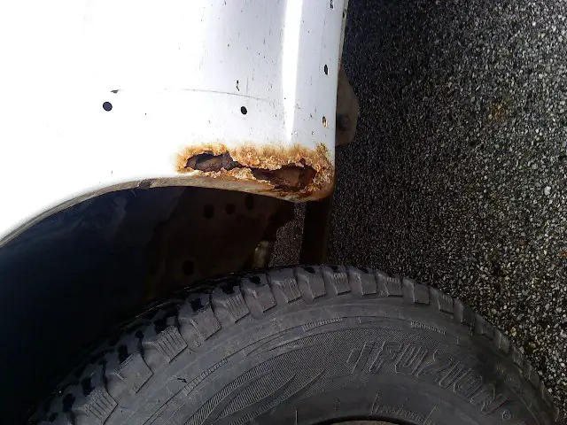

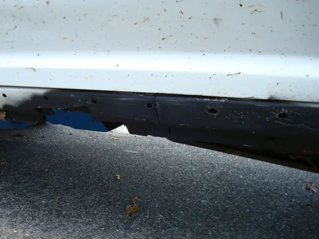

as almost everyone knows the trim is held on by christmas clips and these t clips. both of which have holes in the metal to hold them on. I'm not sure as to why.... but the front fenders have two sets of holes, so i have like 14 holes in the front, and 8 in the back and 10 along the rocker panel. those are fine and all just cover the inside with tape and fill them in with bondo. done. the real problem lies in what i found under that i wasn't expecting (see attached) :splat:
The first picture is of the Passenger side dog leg, this one concerns me the most. I have no experience with patching rust, and I've looked around but there are no 2dr dog legs that are available for replacement, nor do i have a welder that i can use of have any experience with the welder. So i'm not sure how i can do this and have it look right at the end.
As far as everything is concerned the first and more important thing to get done, is get rid of the rust before they start salting the roads. otherwise it's gonna get real bad, real fast. Can anyone suggest a way to stop the rust, as well as a way to fill in the dog leg... my first thoughts are to try to patch it like you would a hole in sheet rock... put a mesh screen on it and put bondo over it and sand it down until it looks normal. but i'm thinking this may not be good because i've never seen it done... i don't really care what it looks like persay as i'm going to be hercing around the wheel wells and the bottom half of the truck once the rust has been fixed.
Any and all help will be appreciated.
Justin

The way I was told on how to fix the holes by my father and several top body shops in my area was. To hit the area of the hole with a hammer. then bondo it up, Otherwise it will be harder to just fill the hole's in. As for your rusted areas, I would recommend welding in some new sheet metal. If you bondo them areas up it will be a crap job imo. I have to find a welder to do mine on my first gen, it looks really bad now that I pulled the running boards off. Actually have mud covering most of it up now :p:
Looks like a mud paint job from the molding on down, A nice chunky light brown ;)
It was actual mud, not muddy water. I attempted to get my explorer stuck in a corn field but that was not going to happen. Buried all four wheels up to the bottom of the rim and even in 2wd it just pulled itself right out like it was nothing. Makes me love it so much more :)

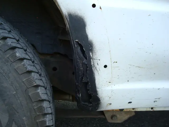

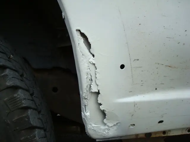

I need more time to find a welder that won't charge me an arm and a leg to do what i want done. So i did a temp fix for now. Let me know what you guys think.
I also did under the lip on the lift gate, but i didn't spray that white as it cannot be seen.
This is the stuff i used is Rust Reformer. You have to sand it down and get all the lose stuff off, then spray this off. it coats like black paint but apparently stops the rust. I wouldn't know if it does, but i'll trust the name. Then i used Dupli-color SUV paint in Oxford white to match my paint the best i could. I think it came out pretty well.
Justin
